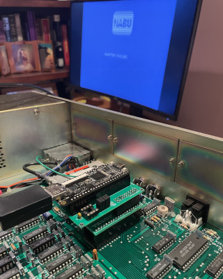

UPDATE: I flashed the V2 bitstream to the Tang Nano 9K and I noticed the following changes:
- on power up, the top 5 LED are always on
- I still get a black screen. When power cycling the TV, for a fraction of a second the expected test screen is shown and then goes black
- this suggests to me that everything is working as correctly.
I wish the firmware had better compatibility with TV's that are picky about standards compliance. I'm sure this will work great with a PC HDMI monitor that can show any signal you toss at it, but if you're testing using a Sony/Samsung/other standards enforcing TV, it might not work for you.

regarding the tang, did you set the jumper correctly ? you need jumper 3 and jumper 4 closed.
The v2 is for the V2 board, it has audio. Did you build the v1 ? you can check the vga if is working.
can you post pictures of your board ?
