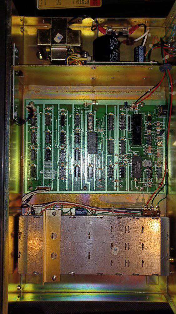

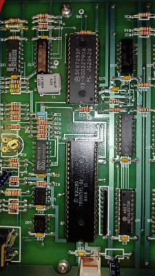

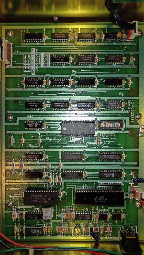

More to follow after I crack the Adapter open and inspecting all components.

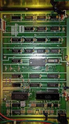

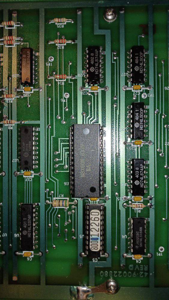

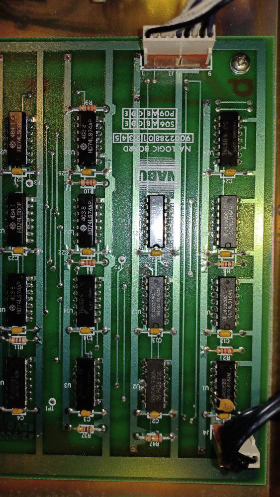

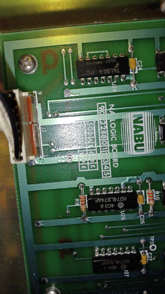

The 74LS245 bus transceiver remains vital for bidirectional communication between digital processing units and modulation circuitry.
The 74LS138 decoder/demultiplexer's importance is heightened for signal routing and control signal generation in QPSK modulation.
Logic ICs like the 74LS32 Quad OR gate, 74LS04 Hex inverter, and others are redefined to support the logical operations and signal processing required for QPSK.

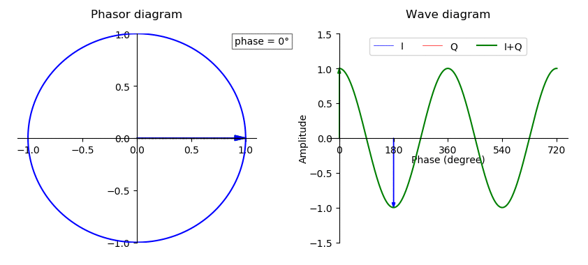

Modulation Hypothesis with QPSK: Leveraging the historical use of QPSK by the NABU Network Adapter, known for its efficient data rate and noise resilience, this project's strategy is to re-implement these features and affirm the adapter's operational capabilities within today's technological landscape.
QPSK is a form of phase modulation technique where the carrier phase changes are used to represent digital information. It employs two signals—In-phase (I) and Quadrature (Q)—each of which can be modulated to carry a bit stream. The phase of the combined signal (I+Q) can take on one of four values: 0°, 90°, 180°, and 270°. Each phase shift represents a two-bit binary code, making QPSK capable of transmitting two bits of digital information per change in phase.
The Python code provided visualizes how the phase of a signal can be manipulated by changing the amplitudes of the I and Q components, a fundamental concept in QPSK modulation. It generates images that illustrate the phasor diagram and the corresponding waveform for various phases, demonstrating how the I and Q components' combination results in a phase-shifted output signal. This visualization helps in understanding how QPSK modulates a carrier signal to encode data by altering its phase according to the I and Q input signals, thereby achieving efficient data transmission in communication systems.
Diagram - Attached
Source: https://en.m.wikipedia.org/wiki/File:Ph ... ulator.gif

- 74LS245: A bus transceiver fundamental for bidirectional data communication.
- 74LS138: A decoder/demultiplexer instrumental in generating necessary control signals.
- 74LS32: A Quad OR gate integral in logic circuits for operational decision-making.
- 74LS04: A Hex inverter crucial for signal polarity inversion.
- 74LS74: A Flip-flop used for managing sequential logic circuits.
- MC1403P: A Voltage reference IC for precision voltage regulation.
- 74LS08: A Quad AND gate employed for basic digital logic operations.
- 74LS00: A Quad NAND gate applied in a variety of logic functions.
- 74LS20: A Dual 4-input NAND gate designed for complex logic operations.

Serial Communication Establishment: Initially, the 74LS245 bus transceiver is paramount for establishing bidirectional data flow, interfacing the digital processing domain with the modulation circuitry. This transceiver's pivotal role ensures the seamless transfer of digital baseband signals, mitigating potential bottlenecks and facilitating robust interfacing between computational and RF domains.
Address Decoding and Signal Routing: Concurrently, the 74LS138 decoder/demultiplexer undertakes the critical task of signal addressing and routing, selecting specific pathways for the digital signals to navigate through the modulation circuit. This component is instrumental in delineating control signals for the modulation process, optimizing the circuit's operational efficiency and data throughput.
Signal Processing and Modulation Preparation
Logical Operations and Signal Manipulation: The incorporation of logic gates, including the 74LS32 Quad OR gate, the 74LS04 Hex inverter, and the 74LS08 Quad AND gate, performs essential logical operations. These operations facilitate decision-making processes, signal inversion for phase state generation, and synchronization of encoding procedures. The Hex inverter, in particular, is crucial for generating the requisite phase inversions, enabling the accurate representation of the QPSK modulation's four distinct phase states.
Data Timing and Synchronization: The 74LS74 flip-flop is utilized for data storage and synchronization, ensuring the serialized data bits are temporally aligned for modulation. This component's ability to maintain bit state integrity is vital for the precise timing and sequencing of the modulation process.
Analog-to-Digital Conversion and Voltage Stabilization
Reference Voltage Provisioning: The MC1403P voltage reference IC provides a stable reference voltage, an indispensable element for the analog-to-digital and subsequent digital-to-analog conversion processes. This stabilization is critical for preserving signal fidelity and integrity, particularly in the conversion stages where digital signals are prepared for RF modulation.
QPSK Modulation and RF Transmission
Modulation and Phase Shift Keying: The core of the QPSK modulation process is facilitated by a composite operation of the digital logic components. The 74LS138 decoder, in conjunction with the array of logic gates, orchestrates the modulation process by generating precise timing and control signals. These signals are then employed to modulate a carrier wave, utilizing the I/Q components derived from the original data stream, and creating the requisite phase shifts that encode the digital information onto the RF carrier.
High-Speed Data Communication Realization: Through the application of these components, the NABU Network Adapter is capable of modulating and transmitting data at speeds up to 6 Mbps. The QPSK scheme, characterized by its efficient bandwidth utilization and noise resilience, enables the transmission of two bits per symbol, effectively doubling the data capacity over simpler modulation schemes without necessitating additional bandwidth.
In the realm of QPSK data transmission, the components of the NABU Network Adapter are poised to collaborate effectively to achieve the target data rate of 6 Mbps. QPSK, or Quadrature Phase-Shift Keying, is a phase modulation technique where each phase shift represents two bits, offering four distinct states per symbol period by altering the carrier signal's phase. This method is exceptionally suited for high data rates and efficient bandwidth utilization.
The function of the ICs in QPSK modulation includes various roles:
- 74LS Series Logic Gates (74LS00, 74LS04, 74LS08, 74LS20, etc.): These gates perform logical operations essential for digital signal processing. In QPSK, they generate the required I (In-phase) and Q (Quadrature-phase) signals by manipulating the input data stream prior to modulation. This logical encoding is compatible with the QPSK scheme.
- 74LS74 (Flip-flop): This component stores and synchronizes data. For QPSK modulation, flip-flops maintain the bit state, crucial for timing and sequencing the bits so they are modulated at the correct intervals.
- 74LS138 (Decoder/Demultiplexer): It controls different circuit parts by decoding address lines and generating chip select signals, routing data within the system or accessing specific memory parts, vital for data flow management during modulation.
- 74LS245 (Bus Transceiver): Facilitates bidirectional data communication. In a modem, it interfaces the digital processing section with other circuits, such as DACs, necessary for converting the digital QPSK signal into an analog form to be carried over an RF signal.
- MC1403P (Voltage Reference): Provides a stable reference voltage, important for maintaining consistent signal levels during analog-to-digital conversion and throughout the modulation process.

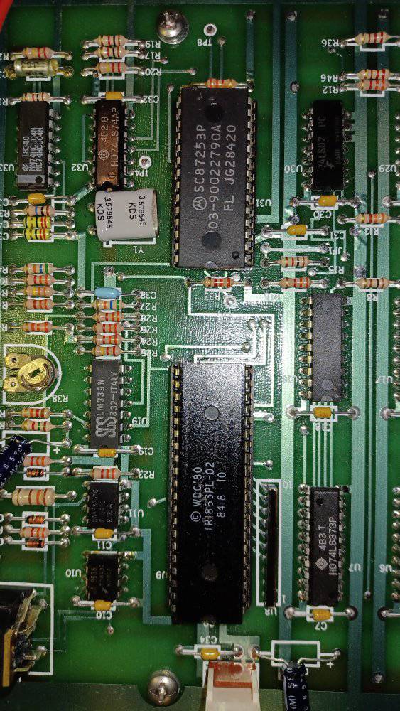

What, no mention of the SC87253P microcontroller? And a lot of AI generated details about generic TTL logic chips and generic task steps? Surely figuring out the firmware that runs the microcontroller would be an important step!
AGMS
Posts: 26
Joined: Tue Feb 20, 2024 9:56 pm
Re: Utilizing the NABU Network Adapter
Post by AGMS »
By the way, in the photos I see a N8X60N large chip (https://www.datasheets.com/part-details ... #datasheet) which is a FIFO address generator (a counter for read address, a counter for write address, a counter for size used) and two 2114 RAM chips (4 bits of data with a 10 bit address https://hardware.speccy.org/datasheet/2114.pdf) located near by. Which suggests a FIFO buffer of 1024 bytes, capable of running at high speed (faster than a software based one) to receive data from the cable TV decoded signal.
So, the largest data packet in the NABU network protocol would be 1024 bytes, including headers.

Yes indeed, though it's more coherenent than that. I'm trying to create a foundation on which to consolidate information and collaborate as no one has much detail or a vision of using the NA until I forced a few hands. My next phase was to work with AI further, unless I had a team of people to help analyze everything. Surely you wouldn't think myself or anyone would try and reverse engineer this on their own lol. Thanks for the input though! Unfortunately, I'm not a strong software guy so there is a lot of room on this mission for others. My background is in electronics, RF, and IT. I did take assembly and C++ many moons ago. I'm open to further input, it would be amazing to be able to get the NA to work in some capcity.
I'm eyeballing this:

One of the pricier programmers. Just need one which can do the NABU EPROM chips. Good discussion about programmers for vintage chips at https://forum.vcfed.org/index.php?threa ... s.1238152/
AGMS
Posts: 26
Post by AGMS »
Actually, even cheaper, just ask around and see if anyone has already dumped that EPROM chip. It has a NABU part number too, which would be worthwhile searching for.
Then you can find out the details about the microcontroller chip, a Motorola SC87253P, which I assume gets its instructions from that EPROM on the adapter circuit board. Might have to locate a Motorola chips catalog from 1984 to find out the CPU information, since it’s not mentioned online anywhere. Then reverse engineer the code to find out the protocol it used (though that may be documented somewhere). Also need to figure out the hardware connected to it. Quite an undertaking!
