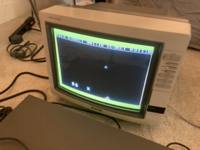

Daily stand-up
Forcing myself to take a couple nights off. Development will resume in a few days.
DONE:
DONE:
- animate aliens back and forth across the screen until at least one alien hits the edge of the screen before changing direction and dropping down 1 tile row.. (This took me a long time to figure out.)
- draw shields on the screen
- controllable player cannon
- bullets (player shooting) - shoot event, bullet animation, clear bullet logic when bullet hits an invader or flies off the top of the screen.
- detect bullets colliding with aliens - Tile level collision only.
- implement game-over detection (player has defeated all the aliens)
- implement shield damage from player bullets
- implement shield defense and damage from alien bombs
- let aliens drop bombs - all code as per bullets but going down and with a different sprite pattern and colour.
- alien death animation / explosion
- detect collision between bomb sprites and player sprite (player dies)
- implement 3 lives system
- implement scoring system and score display text
- implement ufo
- sound effects
- game music
- implement start menu - including ability to play again etc.
- implement high score system.
- implement game levels. Options include increased number of alien bombs at once, faster aliens etc.

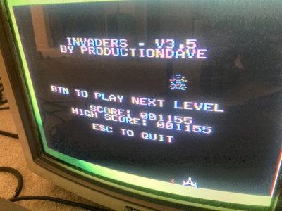

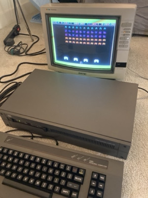

Daily stand-up
I am ready for people to start having a go. I don't seem to be able to upload COM files here. So here is a link to a compiled com file that will work on Cloud CPM.
I have also committed the latest code to the invaders branch on the nabu-games github. https://github.com/linuxplayground/nabu ... e/invaders
And my progress is below. Audio is a bit of a challenge with only the one PSG. So no game music yet.
DONE:
DONE:
- sound effects
- implement game levels. (invaders move a bit faster each time you clear them all out.)
- implement ufo
- game music
