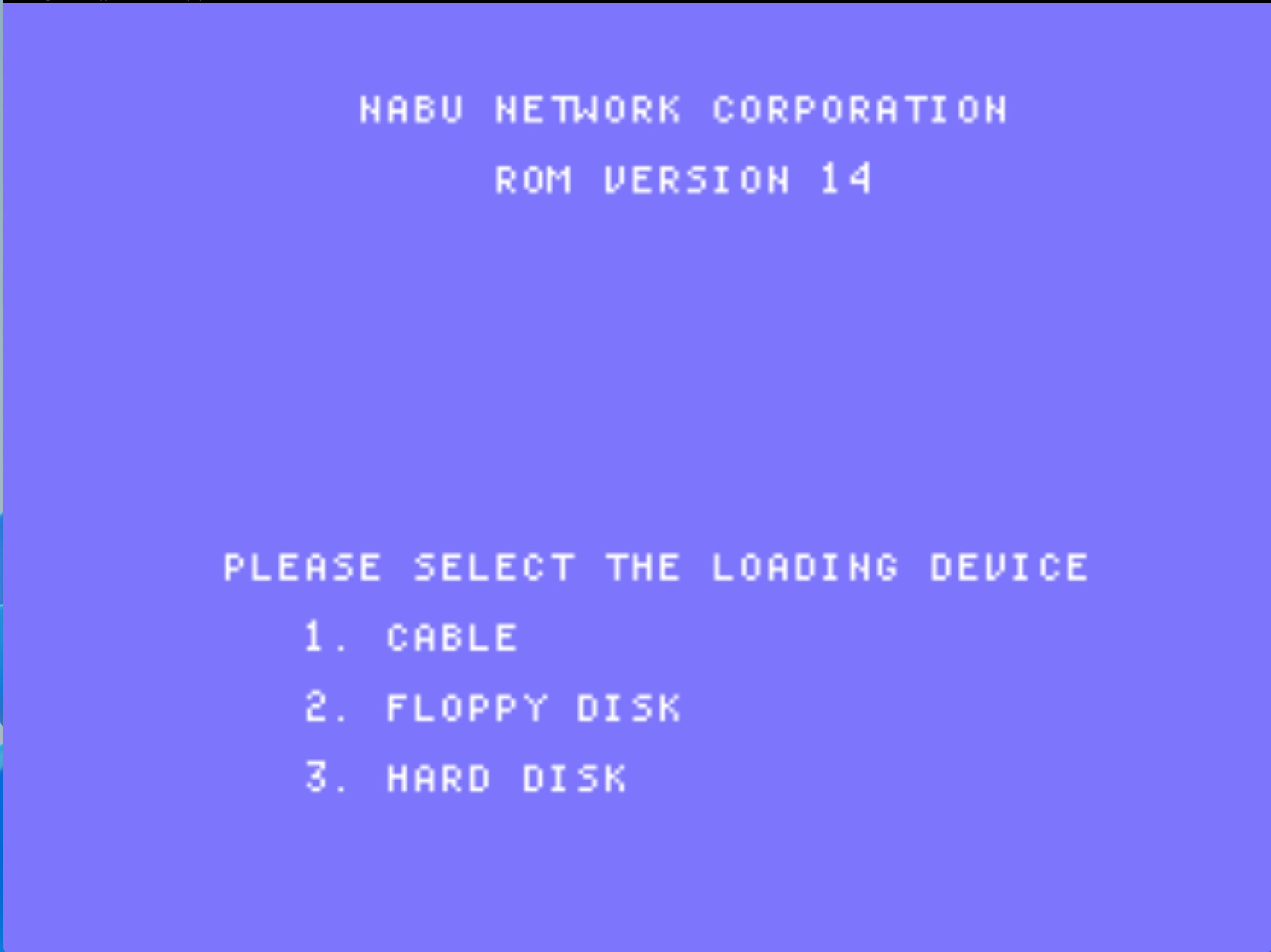

When using this ROM, the startup process will depend on how your NABU is set up. For example, if you have a floppy controller installed and are also connected to a NABU server using a RS-422 adapter, then you will see a menu like this:

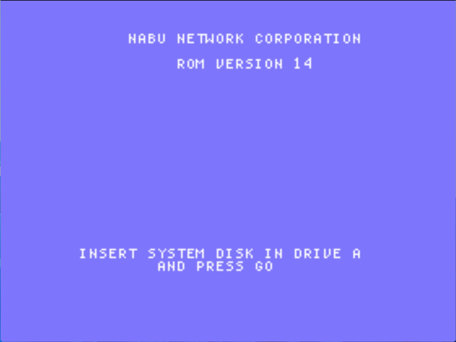

It you have a floppy controller but are not connected to a NABU server, then your NABU will boot directly from a CP/M system disk if one is inserted into the drive (or mounted in mame), and if a boot disk is not found, you will see a prompt to insert a system disk into drive A:

This ROM works fine with mame as well, and as an added bonus if you happen to have mame configured with the hard disk controller (or if you somehow managed to snag a NABU with a real hard disk controller!), booting from the hard drive image will be offered as an option on the menu as well:
