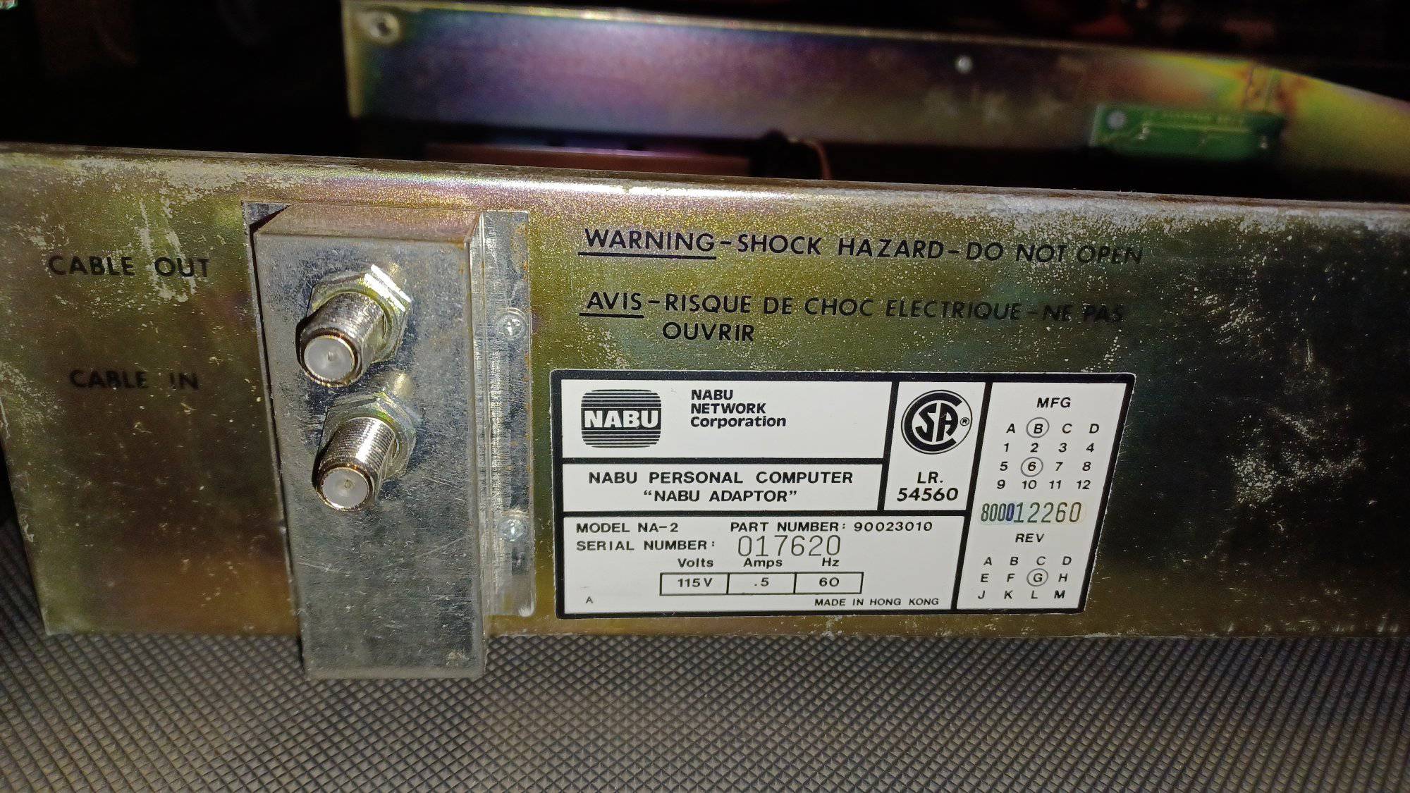

I acquired a NABU Network Adapter (NA-2) to recreate a small-scale NABU head-end. In the 1980s, delivering ~6.3–6.5 Mb/s to a living-room computer was atypical; NABU achieved it by dedicating a single 6-MHz CATV channel to a continuous digital broadcast decoded in the adapter and delivered to the PC over RS-422. Bench-only, isolated coax — do not inject into a live CATV plant. This proposal rebuilds a tiny, safe, bench-top copy of the 1983 NABU cable “head-end” so a NABU computer can load CP/M 2.2 Boot ROM → HCCA handshake → NABU Main Menu and games straight from a single TV channel — no disks, no tapes. A modern RF box (Teleview TVB599/LAN) fakes that one TV channel, continuously broadcasting the right bits. The gray NABU adapter is the translator: it tunes the TV channel, turns the radio-style signal into clean bytes, fixes errors, and feeds those bytes to the computer over RS-422 (≈ 111 kbit/s). Think “early Netflix over one TV channel, looping programs until the computer grabs what it needs.”

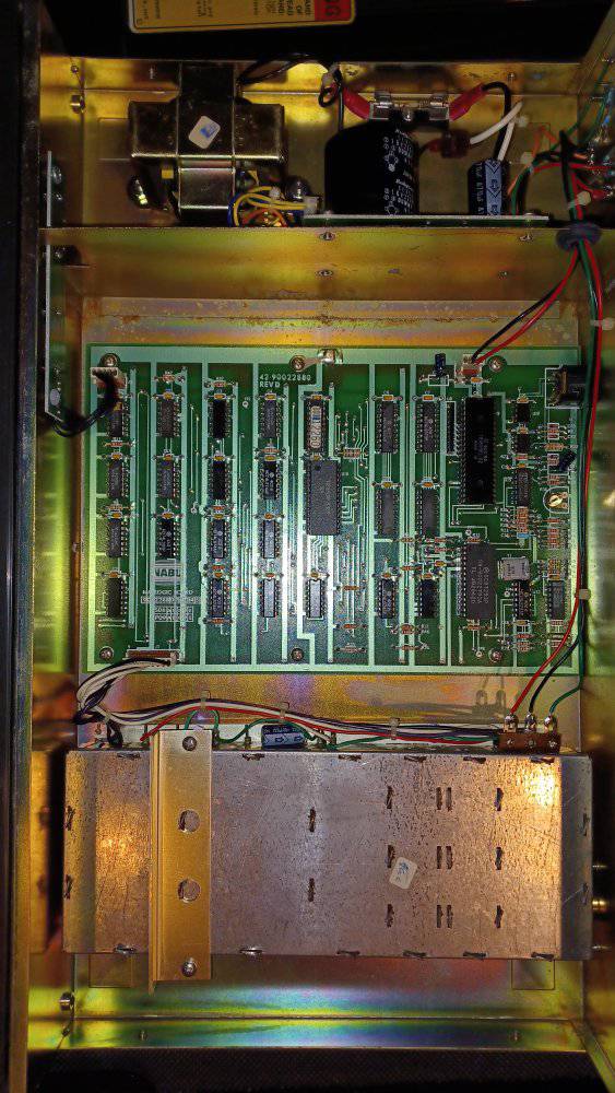

The teardown photographs depict a remarkably intact NABU Network Adapter Model NA-2, identified as a late-production Hong Kong unit (serial 017620). Electrically, the device functions as a miniature cable-TV head-end receiver integrated with a baseband formatter, essentially a compact demodulator station designed to convert a 6-MHz O-QPSK broadcast into serial data for the NABU computer’s RS-422 “HCCA” port.
Inside the Adapter
Two 3.579545 MHz crystals feed HCU04 inverters for timing; LM339s slice symbols; a Motorola SC87253P handles de-scramble, FEC/de-interleave, and CRC; a TR1863 converts dibits to bytes and runs the host link; U5 ROM 800012260 holds framing tables and diagnostics. An N8X60N with two 2114 SRAMs forms an 8-bit × 1024 FIFO, a clean hint that on-adapter transfers cap near 1 KB per block with larger assets segmented by the carousel.
1. RF Front End
The shielded aluminum module located at the bottom of the chassis serves as a broadband tuner and O-QPSK demodulator. It receives the coaxial “CABLE IN” signal, removes the RF carrier, and outputs a recovered intermediate-frequency data stream. The “CABLE OUT” connector operates as a passive pass-through, allowing the television signal to continue on to a standard TV set.

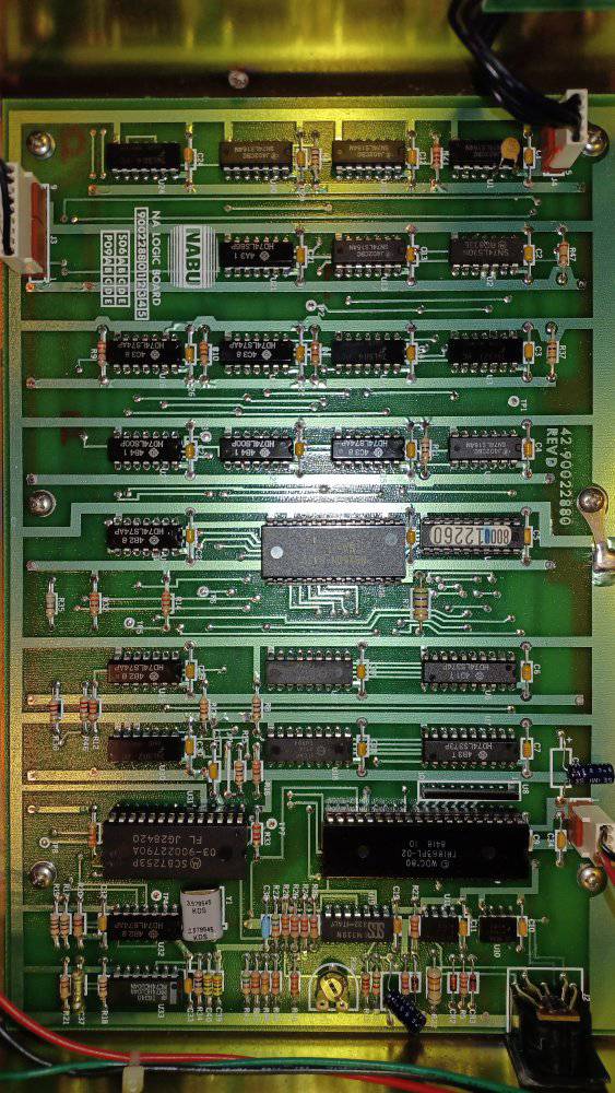

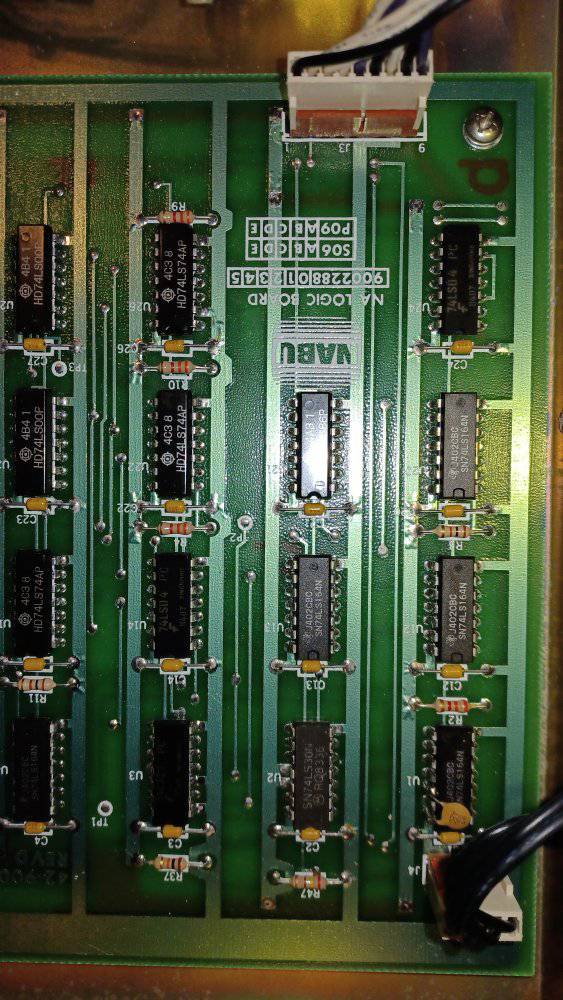

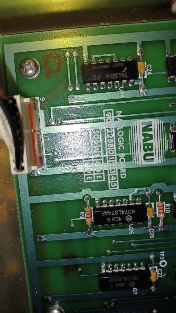

2. Main Logic Board (42-9002280 REV D)

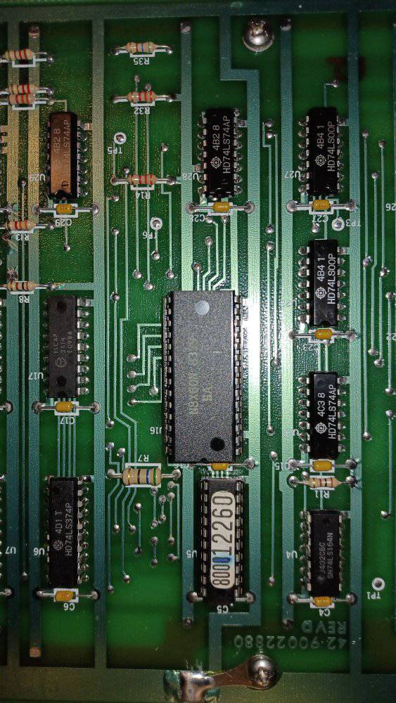

At the core of the system lies the main logic board, which contains the following components:

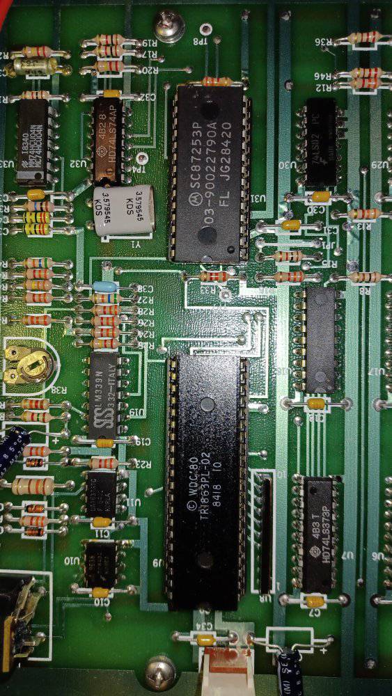

SC87253P (Motorola custom ASIC) – The framing, FEC, and CRC controller that performs descrambling, de-interleaving, and block-integrity verification, converting the continuous bitstream from the tuner into byte-aligned packets.
TR1863P-02 (Mitsumi microcontroller) – Manages timing, command identification, and the RS-422 interface handshake.
ROM 800012260 – Stores the adapter’s firmware table, including scrambler polynomials, interleave depth, CRC seed, and block identifiers.
N8X60N + 2 × 2114 SRAMs – Form an 8-bit × 1 KB FIFO buffer that queues decoded bytes for transmission to the computer at a consistent 111-kbit/s rate.
HD74LS-series logic – A collection of LS74A, LS90, and LS138 devices provides address decoding, data latching, and timing division that regulate FIFO pacing and RS-422 transmission.

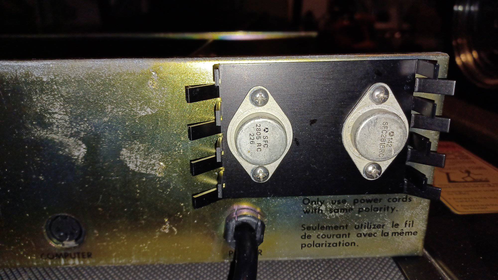

Power regulation is achieved through discrete TO-3 packages marked SFC 2805 RC and 2818 RC, supplying +5 V and +12 V to both the analog and logic sections.

Hardware Verification (Rev D NA-2 Teardown)
Physical inspection of adapter SN 017620 confirms the Rev D Logic Board 42-9002280 used in this proposal.
• Shielded tuner/IF module verified as the O-QPSK front-end delivering baseband into the SC87253P.
• U5 ROM 800012260 present (undumped as of Rev 1.8), socketed, and bus-connected to the Motorola controller.
• SC87253P + TR1863P-02 pair confirmed as demod/framing + host MCU path.
• FIFO assembly (N8X60N + 2 × 2114 SRAMs) verified = 8-bit × 1024 bytes (1 KB).
• Power regulation via TO-3 SFC 2805 (+5 V) / 2818 (+12 V).

A Motorola-marked SC87253P (mask MCU/ASIC, confirmed on Rev D board adjacent to U5 ROM 800012260) orchestrates demod state, de-scramble/de-whiten, FEC/de-interleave, and CRC; a Western-Digital-marked TR1863PL-02 handles dibit → byte conversion with clock/framing and services the host RS-422 port (HCCA). 74LS-series glue (’00/’02/’04/’74/’164/’330/’373/’374) provides shift/latch stages, byte assembly, and small FIFOs. ROM U5 (label 800012260) contains framing tables, polynomials, command set, and diagnostics. Board traces confirm address and data bus connectivity between U5 and SC87253P, cementing U5 as the controller’s firmware table and scrambler/FEC source. Output is a byte stream of NABU carousel blocks with valid CRCs for the host-link engine.

High-speed FIFO buffering. Adjacent to the SC87253P are an N8X60N FIFO address generator and two 2114 SRAMs (4-bit × 1024 each). Paired 2114s yield an 8-bit × 1024 (~1 KB) FIFO while the N8X60N supplies read/write address and fill-level counters. This enables continuous dibit→byte capture at symbol clock without MCU stalls and likely bounds single on-adapter block transfers to ≤ 1024 bytes (incl. header/CRC).

How My Proposal 1.8 Relates to Jared Boone’s “40-Year-Old Cable Modem” Teardown and Evolved into the Rev 1.9 Distributed Architecture
In early 2024, I began a proposal to try and resurrect the NABU Network Adapter. Proposal 1.8 was a technical plan to reconstruct, in a controlled bench-top environment, the NABU’s original head-end broadcast pathway and adapter function using modern RF hardware to recreate the 6 MHz CATV channel that once streamed digital programs directly into living-room computers. In the 1980s, NABU was transmitting roughly 6.3 megabits per second, at a time when home users were downloading at 300 baud. The NABU adapter effectively operated as an early digital cable modem: it tuned to one TV channel, decoded a continuous digital carousel, corrected errors, and handed the resulting byte stream to a Z80-based NABU personal computer via RS-422 differential serial lines. My reconstruction plan aimed to reproduce that entire signal path safely, without connection to a live cable plant, using a Teleview TVB599/LAN modulator to simulate a single analog channel while maintaining the original NABU’s data rates, timing, and frame structure.
I began by disassembling a NABU Network Adapter Model NA-2, serial number 017620, a late-production Hong Kong build. Inside, I found the architecture of a miniature broadband receiver: a shielded RF tuner for O-QPSK demodulation, a logic board labeled 42-9002280 Rev D, discrete timing circuits, and a 1 KB FIFO interfacing to the NABU PC through RS-422. Two 3.579545 MHz crystals provided stable timebases for symbol slicing, while LM339 comparators converted analog I/Q waveforms into logic-level symbols. At its heart was a Motorola SC87253P ASIC responsible for de-scrambling, forward-error correction, de-interleaving, and CRC verification. It was paired with a Mitsumi TR1863P-02 microcontroller managing byte-to-frame sequencing and host handshake logic. A socketed ROM labeled 800012260 contained firmware tables, scrambler coefficients, FEC parameters, block IDs, and diagnostics. Adjacent, an N8X60N address controller and two 2114 SRAMs formed an 8-bit × 1024-byte FIFO buffering continuous data bursts from the RF section before serializing them to the computer at roughly 111 kbit/s (8-N-1 framing). The digital section used HD74LS-series TTL logic for address decoding and timing division, while SFC 2805 (+5 V) and 2818 (+12 V) TO-3 regulators provided isolated rails for analog and logic domains. Tracing confirmed that all major data lines, address, control, and clock, matched the architecture I had hypothesized months earlier.
I documented the entire signal chain: the RF front-end accepted coax input, filtered and down-converted the modulated signal to baseband, then delivered the bitstream to the SC87253P for deframing, FEC, and CRC correction. The verified 1 KB FIFO confirmed that NABU transmitted fixed-length block segments consistent with carousel looping. Once valid data arrived, the TR1863 serialized it over RS-422 to the computer, which polled for block IDs (bootloader, CP/M 2.2, main menu, etc.). Because the broadcast was one-way, no return channel existed, each computer simply listened until the desired block reappeared. Measured throughput equated to a 3.2 megabaud QPSK signal within a single 6 MHz channel, producing an effective data rate of 6.3–6.4 Mb/s, precisely what NABU engineers achieved in 1983.
To emulate the head-end, I used the Teleview TVB599/LAN modulator, which accepts Ethernet RTP/UDP streams and generates RF output at configurable frequencies, symbol rates, and FEC values. My bench setup placed a content server feeding the modulator, which then drove the adapter via short, isolated coax; the adapter’s RS-422 output fed the NABU PC. An optional HF2211A RS-422-to-Ethernet bridge monitored traffic for capture and network streaming. The chain was: Content Server → Teleview Modulator → Coax → NABU Adapter → RS-422 → NABU Computer, with optional sniff branching. Modulation parameters were strict: O-QPSK at 3.200 Msym/s, roll-off 0.25, FEC 3/4, RF level +4 dBmV, with contingencies to sweep symbol rate ±10 %, roll-off 0.20–0.35, and FEC 3/4 → 2/3 → 1/2 if lock failed. Expected MER ≥ 28 dB and EVM ≤ 4 %. The carousel repeated system blocks every few seconds (menu, CP/M, titles) so the NABU PC could boot autonomously. CRC verification at the adapter’s FEC layer ensured block integrity.
Verification included measuring voltage rails (< 50 mV ripple), confirming timing signals at 3.579545 MHz, observing LM339 slicer outputs in phase with the symbol clock, and probing the SC87253P’s CRC-error pin for clean lock (low = healthy). On the RS-422 lines, ± 2–3 V differential swings at 111 kbit/s matched FIFO burst output. Once operational, projected boot times were ≈ 10 s for CP/M 2.2 and ≈ 2 s for the main menu. Further analysis would dump ROM U5 (800012260) to extract scrambler polynomials, CRC seeds, and interleave depth, correlating ROM lookup tables to RS-422 command IDs like INIT, READ-BLOCK(ID), STATUS, and RESET. Each stage mapped directly to verified hardware, not assumption, bringing NABU’s 1983 broadcast modem into a 2020s lab with full electrical isolation.
Historically, this teardown and reconstruction proved that NABU’s technology was decades ahead, a 6.3 Mb/s digital broadcast in 1983 that prefigured modern cable modems, streaming, and app-store delivery. My documentation bridged that history to contemporary tools, showing how its analog tuner, digital FEC, and serial interface can be recreated precisely using accessible RF modulators and a single coax run on the bench.
When compared to Jared Boone’s October 2023 teardown video, The 40-Year-Old Cable Modem (Part 1), my January 2024 Proposal 1.8 emerges as a parallel, and in many areas more comprehensive, investigation. Both projects focused on reviving the adapter by reconstructing its RF path and logic, though our approaches diverged: Boone worked empirically, measuring live spectrum behavior; I approached it architecturally, deriving symbol timing and digital framing beforehand.
Shared findings are extensive. Both identify the adapter as a receive-only digital cable modem on a single 6 MHz CATV channel; both pinpoint ≈ 6.3 Mb/s O-QPSK data rate; both note a 324 MHz local oscillator, ≈ 57 MHz intermediate frequency, and an incoming broadcast centered at 264–270 MHz (Channel 31). Boone’s oscilloscope trace confirmed the 260–280 MHz filter and CABLE LED engagement around 267 MHz; my model predicted the same VHF slot. Boone measured IF = 56.988 MHz using the 14.247 MHz crystal × 4; I recorded two 3.579545 MHz crystals for symbol/timing, likely revision variants. Boone demonstrated the quadrature demodulator feeding XOR/flip-flop differential decoding; I mapped LM339 comparators and HCU04 inverters performing the same function. Both paths yielded the identical result: the adapter translates an O-QPSK carrier into a clocked, byte-aligned digital stream.
Boone’s video excels in empirical precision, defining center frequency 267.012 MHz, ideal input window −70 to −45 dBm, and clock relationships (14.247 MHz IF ÷ 4 and 3.1555 MHz symbol ÷ 2). These data points tightened my RF bench parameters. Conversely, my proposal adds the digital subsystem Boone did not examine, the SC87253P/TR1863P-02 pair, FIFO architecture, ROM 800012260, and RS-422 host interface. He ended with the analog front-end; I completed the digital back-end.
Both reconstructions agree the adapter is a one-way, self-timed, block-looping system, what I term a carousel and he described as “predictable bits coming out of the demodulator.” My 3.200 Msym/s symbol model aligns with his 6.312 Mb/s bit rate (2 × 3.156 MHz). The minor differences fall within expected rounding between symbol and bit representations.
Methodologically, mine is architectural and reconstructive, defining electrical limits, safety isolation, and ROM extraction plans, while his is forensic and confirmatory, validating measured frequencies and gain. Together they form two halves of the same puzzle: my proposal predicts how the NABU adapter should behave, and his work proves that it does.
Ultimately, the projects converge in principle and complement each other in scope. Boone’s 2023 teardown added exact frequencies, power windows, and crystal relationships that verified my calculations. Combined, our work fully decodes the NABU adapter from RF front-end to RS-422 output, completing the most accurate modern reconstruction of the world’s first broadband home computer network, and laying the foundation for the distributed Rev 1.9 architecture that extends this recreation across Ethernet and SDR-linked nodes worldwide.
Short take
I was on target; his teardown adds exact frequencies, levels, and lock behavior I can fold into Rev 1.9 while my doc covers the digital/host half he didn’t open from what I saw.
Strong matches (mine vs. his)
Channel & bandpass: I assumed a single 6-MHz CATV slot; he empirically pins Ch. 31 (264–270 MHz) via an external BPF.
LO/IF plan: I targeted a classic TV-tuner IF chain; he measures LO ≈ 324 MHz, IF = 56.988 MHz (from 14.2470 MHz × 4).
Modulation & rate: I modeled O-QPSK ~6.3 Mb/s; he confirms O-QPSK, 6.312 Mb/s with 3.1555 MHz crystal → bit clock (×2 ≈ 6.311 Mb/s).
Bench-only, one-way, carousel: My safety/looping approach matches his receive-only bench reconstruction.
Quadrature/differential demod: I described slicers/comparators into digital logic; he shows quadrature demod + XOR/FF differential decoding, conceptual match.
Useful specifics from his video I’m adopting
Center frequency: 267.012 MHz (not just “somewhere in Ch. 31”).
Input power window (AGC sweet spot): −70 to −45 dBm into the IF chain.
Synth math (PLL programming): 8 MHz ref, R=512, N=324 → LO 324 MHz.
Lock-zone behavior: LED thresholds, DATA_OUT “deadband,” and phase lead/lag around 267 MHz for acceptance tests.
Where my proposal goes beyond his Part 1
Digital board details: SC87253P (descramble/FEC/CRC), TR1863 (host/HCCA), U5 ROM 800012260 (tables/polynomials), 1 KB FIFO (N8X60N + 2×2114).
End-to-end plan: Teleview TVB599/LAN profile, carousel cadence, RS-422 ~111 kbit/s (HCCA), ROM/protocol-dump workflow, non-destructive bus sniff, capture/analysis path.
Discrepancies to reconcile (and my stance)
Crystals/timing: My NA-2 Rev D shows two 3.579545 MHz refs near slicer/filters; his unit emphasizes 14.2470 MHz (IF) and 3.1555 MHz (bit clock). I’ll mark as revision-dependent and annotate roles (my cans likely pre-slicer timing/BPF; his crystals anchor IF and symbol/bit clocks).
Symbol rate/FEC/interleave: My starter set (3.200 Msym/s, RRC α=0.25, FEC 3/4) stays provisional pending U5 dump and/or on-air/RS-422 captures. His video hasn’t published FEC/interleave yet.
Rev 1.9 concrete updates
Fix Fc=267.012 MHz, LO=324 MHz, IF=56.988 MHz in configs and diagrams.
Specify AGC operating window −70…−45 dBm at adapter input; add attenuator/pad guidance to hit it.
Publish NABU-QPSK-3.2M profile (symbol rate, roll-off, pilot/levels) plus exact PLL programming notes.
Add acceptance tests: LED threshold sweep, DATA_OUT deadband band-edge checks, I/Q phase lead/lag verification.
Include two timing families: (A) 14.2470/3.1555 MHz path; (B) 3.579545 MHz rev, callouts per PCB revision.
Tooling & transport implications
If TVB599 can’t emit raw framed bytes to match NABU framing/FEC:
Plan A: SDR Tx/Rx (USRP/BladeRF/HackRF) for exact O-QPSK waveform.
Plan B: Tunnel NABU blocks in CBR MPEG-TS with a TS→raw micro upstream of TVB599.
Clock discipline: Lock content server + modulator via shared 10 MHz or PTP; drift → CRC-err spikes.
Verification sequence (tight, pass/fail)
V0 RS-422: ~111 kbit/s, 8-N-1, request/ack bursts; ±2–3 V diff swing.
V1 RF lock: Carrier detect, stable symbol clock; CRC-err low at MER ≥ 28 dB, EVM ≤ 4%.
V2 Bootstrap: CP/M 2.2 ≤ 10 s post-lock; Main Menu ≤ 2 s after.
V3 Throughput: 10× title loads, zero CRC retries at nominal MER; burst histogram shows ≤ 1024 B chunks (FIFO-bounded).
V4 Stress: Double title size; latency scales with carousel period, not RS-422 stalls.
ROM/protocol recovery plan
Bus sniff: Clip U5/SC87253P A/D; capture address walks during boot/menu to infer table use.
Scrambler/CRC: Record post-slicer dibits; Berlekamp–Massey for LFSR taps; brute-force CRC poly.
ROM dump: Read U5 800012260 (adapter/fixture or in-circuit stepping/FPGA snoop).
Correlate: Map HCCA commands (INIT, READ-BLOCK(ID), STATUS, RESET) and block header (sync, ID, length, CRC) to RS-422 traces.
Instrumentation & fixtures
Shielded bench box; 50/75 Ω terminations; 20–30 dB fixed attenuators and pads.
2-ch scope + logic analyzer on RS-422, TR1863 “byte ready,” CRC-err, FIFO flags, symbol/byte clocks.
BER/MER meter or SDR sniffer for pre-slicer IQ; handheld spectrum sniffer for leakage checks.
Safety/compliance
Bench-only, isolated RG-6; no injection into live plant; verify no emissions around the chosen 6-MHz slot.
Documentation adds
Pin-level net map (U5/SC87253P/TR1863), FIFO flags, RS-422 pinout/termination, common-mode and max run.
Bit-level NABU header spec (sync, block-ID, length, CRC, interleave depth once known).
Timing diagram: HCCA request → adapter burst → FIFO refill.
Rev-dependent crystal/timing appendix with photos/silkscreen callouts.
Nice-to-have stretch
Golden SDR pack: IQ of a known-good carousel + matching RS-422 capture.
FPGA core: SC87253P-equivalent (descramble/FEC/CRC) once polynomials verified.
Public repo: RS-422 tap schematic, NABU-QPSK-3.2M configs, minimal carousel builder, acceptance scripts.
Bottom line
RF architecture/modulation: aligned; his data tightens mine.
Digital/host integration: my doc leads; his Part 1 validates the RF front half.
Rev 1.9 will lock frequencies/levels, add acceptance tests, and push FEC/scrambler/CRC from TBD → verified via U5 + captures, closing the loop server → RF → adapter → RS-422 → PC exactly as in 1983.
Future 1.9 Plans:
The NABU Network Restoration – Revision 1.9 Distributed Architecture Proposal
The next phase of my NABU restoration project expands from isolated bench emulation to a functioning distributed NABU broadband ecosystem, rebuilt with modern Ethernet-to-RF and RF-to-Ethernet technology that recreates the original 1983 head-end model with digital precision and safe isolation from any live CATV plant. The objective is not mere preservation, but operational resurrection, reviving NABU’s 6.312 Mb/s O-QPSK data stream across a controlled IP backbone while maintaining the same timing, framing, and error-correction logic defined in the original hardware ROM U5 (800012260).
In this design, the central head-end acts as a digital NABU server, broadcasting reconstructed carousel data or, alternately, relaying authentic captures of the original signal via a software-defined radio (SDR) tuned to Channel 31 (264–270 MHz). These baseband in-phase and quadrature (I/Q) samples, representing the verified 3.200 Msym/s modulation rate and O-QPSK structure, are encapsulated into RTP/UDP multicast streams to preserve symbol-level phase coherence. The streams travel across a secured Ethernet or VPN backbone to authorized client nodes, where local Teleview-class modulators or SDRs regenerate the RF waveform at 267.012 MHz, outputting through shielded RG-6 coax directly into genuine NABU Network Adapters. From the adapter’s point of view, nothing has changed since 1983: it locks to the carrier, performs forward-error correction and de-scramble via its SC87253P/TR1863P-02 pair, buffers each 1 KB frame through the N8X60N + 2×2114 SRAM FIFO, and transmits verified byte streams over RS-422 (~111 kbit/s) to the Z80-based NABU computer, which boots CP/M 2.2 → Main Menu → titles exactly as it once did in Ottawa.
Each node therefore becomes part of a symmetrical RF–IP–RF network, a distributed cable system reborn through packet switching. The architecture supports two fidelity modes:
1. Full I/Q replication, transmitting the exact modulation envelope for laboratory-grade authenticity.
2. Byte-stream synthesis, where the head-end multicasts verified carousel blocks and each home node’s FPGA or SDR reconstructs the waveform locally using the same FEC, scrambler polynomial, and symbol parameters (roll-off 0.25, FEC 3/4).
To ensure deterministic playback, all nodes synchronize clocks via Precision Time Protocol (PTP) or a shared 10 MHz master reference, maintaining sub-microsecond phase alignment and eliminating constellation drift. Signal integrity is validated at MER ≥ 28 dB and EVM ≤ 4 %, with attenuation calibrated for the adapter’s historical −70 to −45 dBm AGC window.
Safety remains absolute: all RF paths are fully enclosed and terminated in 75 Ω, radiated emissions monitored with near-field probes, and total output limited to < +4 dBmV. The system operates entirely as a receive-only network with no return channel, mirroring NABU’s original one-way topology while using IP for transport instead of coaxial trunking.
Revision 1.9 Roadmap
Integrate Boone’s empirical parameters, LO 324 MHz, IF 56.988 MHz, Fc 267.012 MHz, AGC −70 to −45 dBm, into all Teleview and SDR profiles.
Finalize and publish the NABU-QPSK-3.2M reference waveform with PLL and clock-discipline tables.
Complete ROM U5 (800012260) extraction, decode its scrambler, FEC, and CRC routines, and verify through RS-422 capture.
Develop an FPGA-based SC87253P emulation core for descramble/FEC/CRC validation.
Implement a multi-node PTP-disciplined sync test to measure phase stability and MER drift across distributed clients.
Release an open NABU Rev 1.9 repository containing head-end server code, multicast configuration scripts, modulator profiles, and annotated teardown schematics for future researchers.
The result will be a virtualized NABU cable network, a globally distributed, RF-accurate, and historically faithful recreation of one of the world’s first consumer broadband systems. In essence, the project transforms what was once a forgotten 1983 experiment into a live, operational artifact of pre-Internet networking, bridging four decades of technological evolution and allowing a new generation to experience digital streaming as it existed before the web was born.
