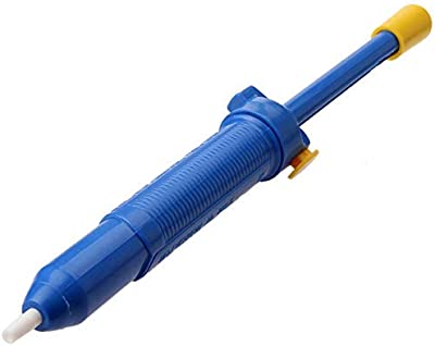

DJ Sures wrote: Sun Apr 30, 2023 7:09 pm Oh that's too bad. You know what? I needed a solder sucker at my cabin last summer. I found this on Amazon:
I have to say, it's pretty awesome. I actually really enjoy using it and for the price, you can't go wrong. So if you don't have one of these in your arsenal, i'd recommend it!

Totally! And it actually works. I was doubtful when I got it - but figured it would be worth trying it. Used it to recap my fat mac and se/30.

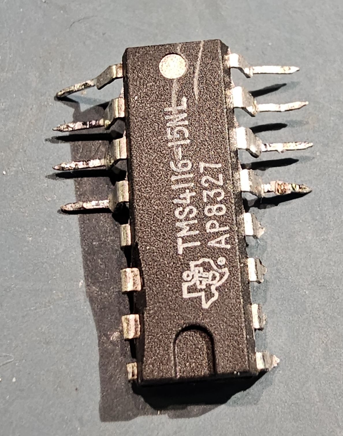

Had to cut out the little bugger to get all the legs out of the through holes:

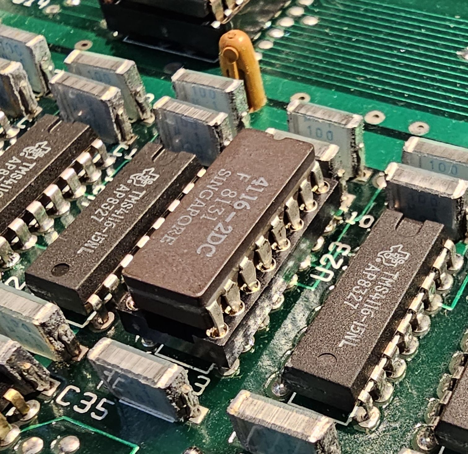

The new and improved DRAM in socket:

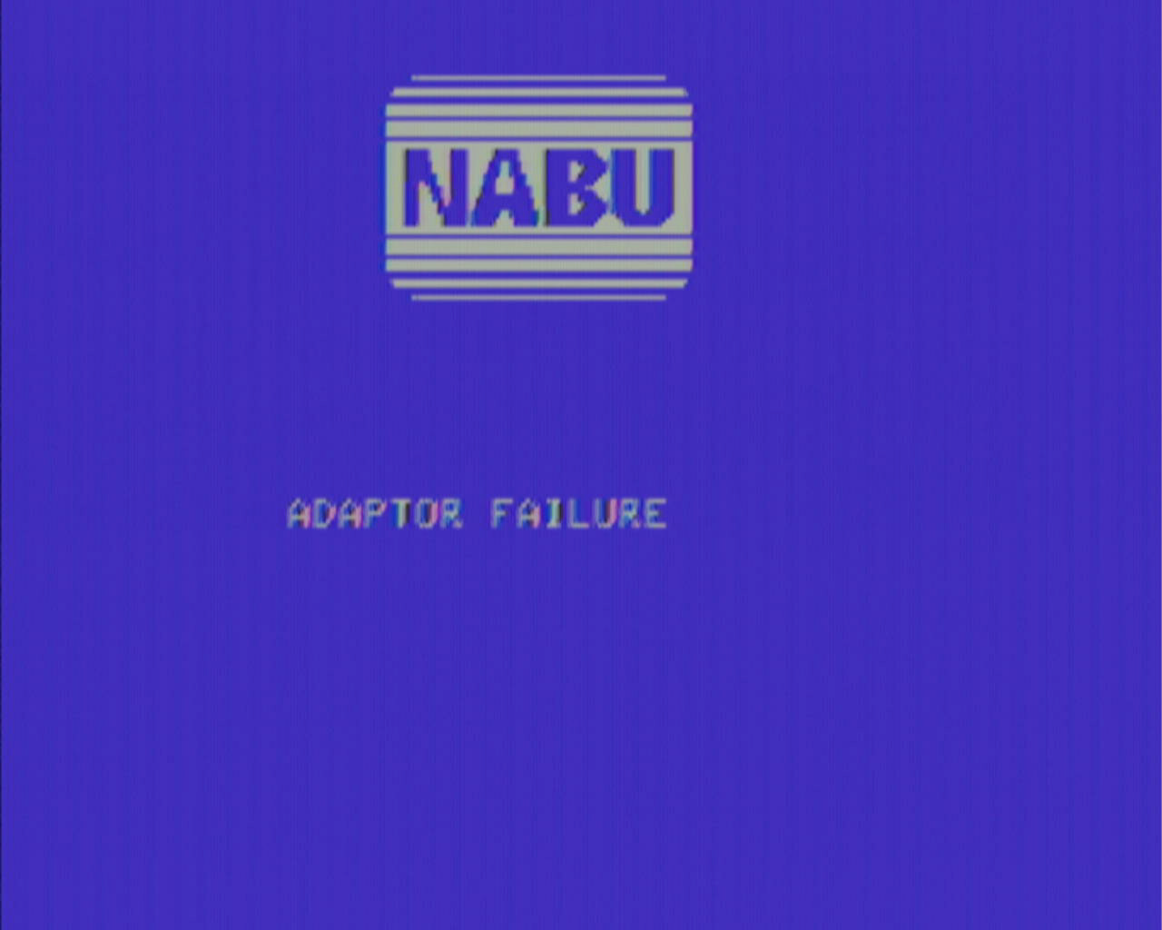

Now on to the adaptor failure...

DJ Sures wrote: Sun Apr 30, 2023 7:09 pm I have to say, it's pretty awesome. I actually really enjoy using it and for the price, you can't go wrong. So if you don't have one of these in your arsenal, i'd recommend it!
The price for this just dropped from $59.99 to $36.99 (Canadian) and with $3 coupon it's $33.99. (...which unfortunately put it under the $35 free shipping limit, so I had to get something else with it)

One bit of warning. When you press the button, it creates a sucking action. If you release the button, any solder in the tube falls out. So you do NOT want to release the button while the tube is over the circuit board :D Lesson learned!
What I do is suck the solder, and keep the button held. Move the sucker over to an old container, release the button and the solder falls out into the container.
