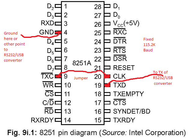

Follow the attached U4 8251 diagram for connections. Connect TxC (pin9) jumper to system's 1.79HMz CLK (pin 20) to provide a baud clock for TX. Serial TX out (pin 19) and the 8251A ground (pin 4) or from another ground source. This mod should be solderable from the top side of the PCB board with very little effort with basic soldering skills. Connection to a +5V compatible USB serial dongle for use with devices that are capable with USB based serial COM port support from the host OS, i.e. Linux/Windows etc. or a RS232C converter for a PC computer or dumb terminal with a DB9 or DB25 connector which usually means RS232C. Using a real ADM3 might be a challenge since the max baud rate is 19.2k baud since this HW mod will only provide 115.k baud. Many VTxxx terminals support faster speeds. (see below for option explanation*) An emulated ADM3 PC based terminal program will handle a wide range of what the USB serial and PC can do.
This mod only runs at 115.2k baud rate (or 111.875k baud to be exact with 1.79 MHz clock) But is close enough for terminal to receive ok at 115.2k baud rate.
*If another baud is needed then the TxC needs to be changed to 16 times the desired baud. For instance a real ADM3 terminal max baud is 19.2K. So a TxC clock needed is 19200 x 16 = 307.200k KHz. This clock is needed instead of 1.79 MHz. The are devices that can be used to generate baud clock with dip switches and some that are programmed via Z80 CTC or other programmable counter/timer chips. The reproduction NABU TX/RX serial card uses a CTC for example.

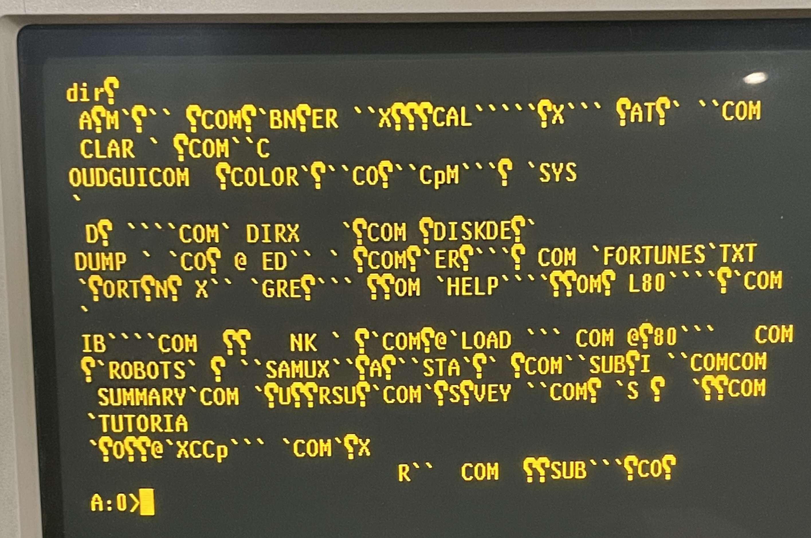

Such a great little mod. Super easy to do & totally reverseable. I got this to work just fine with a USB adapter & minicom on my Macbook but I couldn't make it work with my DEC VT-510 terminal. We had some discussion about it on Discord but thought I'd post here in case anyone else had ideas.
All I got was a series of reversed bold question marks on every key-press. I suspect the VT-510 is just more sensitive to the baud rate being slightly off from 115.2k but I don't have any crystal oscillators to fix that currently. I connected ground to pin 7 (SIG GND) & TX to pin 3 (RX) on the female comm1 port as per the manual (http://bitsavers.org/pdf/dec/terminal/v ... _Nov96.pdf) & configured the VT-510 for 115.2k/8N1/flow-control off.

Does the VT510 need TTL UART or RS232? Because the voltage is considerably different. Also, isn't rs232 inverted from ttl?
If not, you could always make a BAUD converter without modifying the nabu using an Arduino. If you use a low-cost Arduino ProMicro, which as 2 UART ports it would be easy.

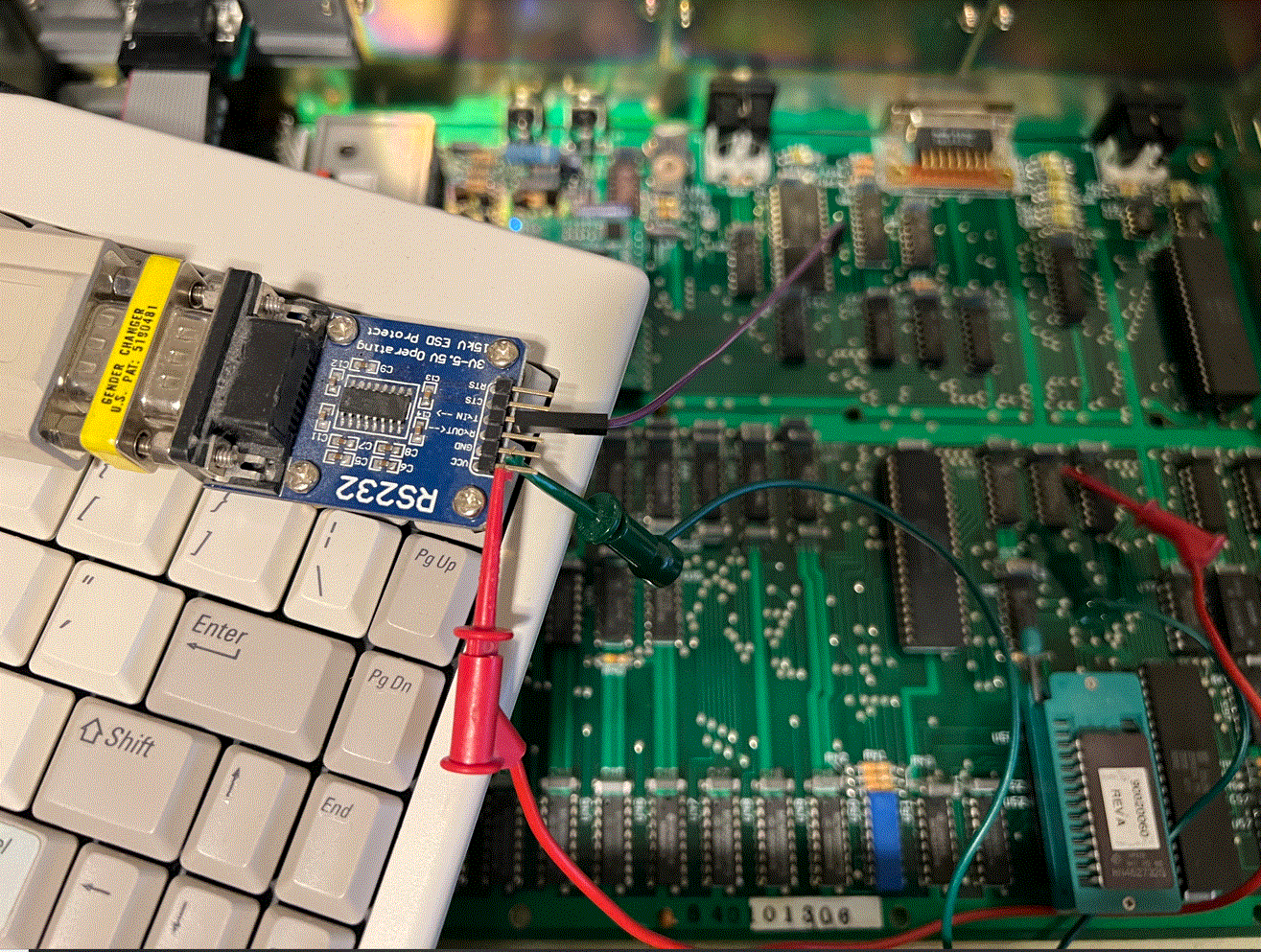

Like DJ says you need a TTL to RS232 converter for this to work. You might want to spend a little more and get the DB9 connector with the RS232 circuitry to make it easier. For example: It is also clearer on how to wire it up too. Connect GND and TX to the appropriate pins on the converter.

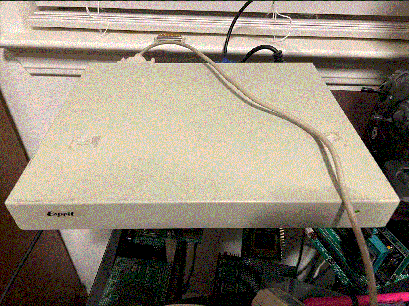

I do have a commercial thin "Pizza Box" style serial to VGA terminal box that will emulate the VTxxx series with RS232. I'll give it a try tonight if I find time otherwise tomorrow night. I was having mixed results with the PC HyperAcess and VT52 mode with VTEST52.com. Mostly worked with screen position etc. but the clear screen didn't appear to work. ADM3A looked ok with the terminal program.

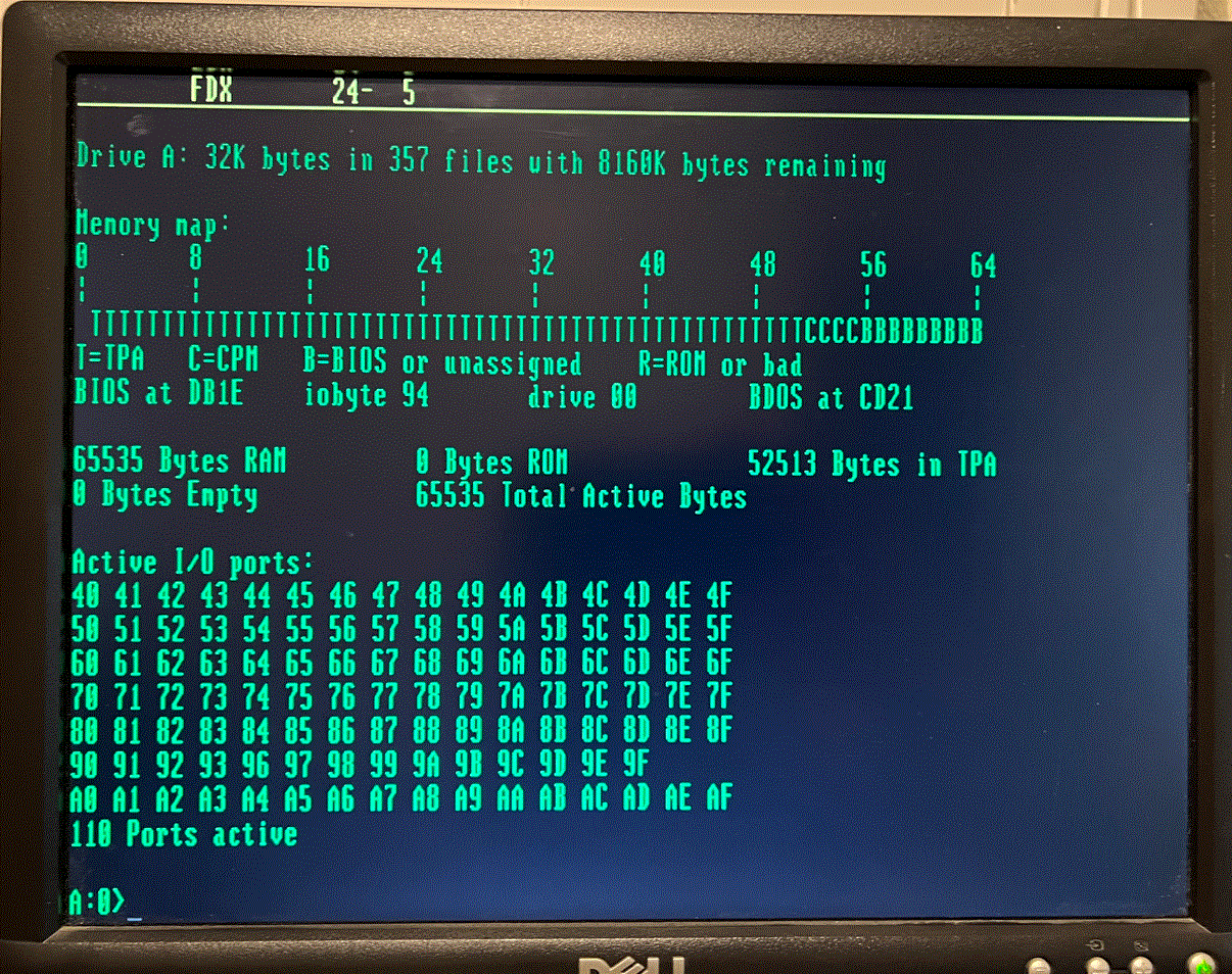

The following pictures are from the RS232 adapter to the Esprit serial to VGA terminal. Three connections: +5, GND and TX data. Basic connection is good at 115.2k baud.

I think my missing piece here must be the rs232 conversion. I have an older version of the module you are using there but it's in use elsewhere so I'll have to rig something else up. I'd really like to try building something with those MAX3232 chips I have. Perhaps build something into a 3d-printed expansion cover that has a DB-9 sticking out the back.
I tried messing around with a Feather RP2040 (aka Pico) and was able to receive from the Nabu but couldn't send to the VT510 (same reversed question marks if anything at all). It's definitely a learning experience all along the way but that's what makes it fun :)

Getting closer with the rs232-TTL adapter! Seems like I still have a setting wrong somewhere though.
