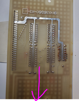

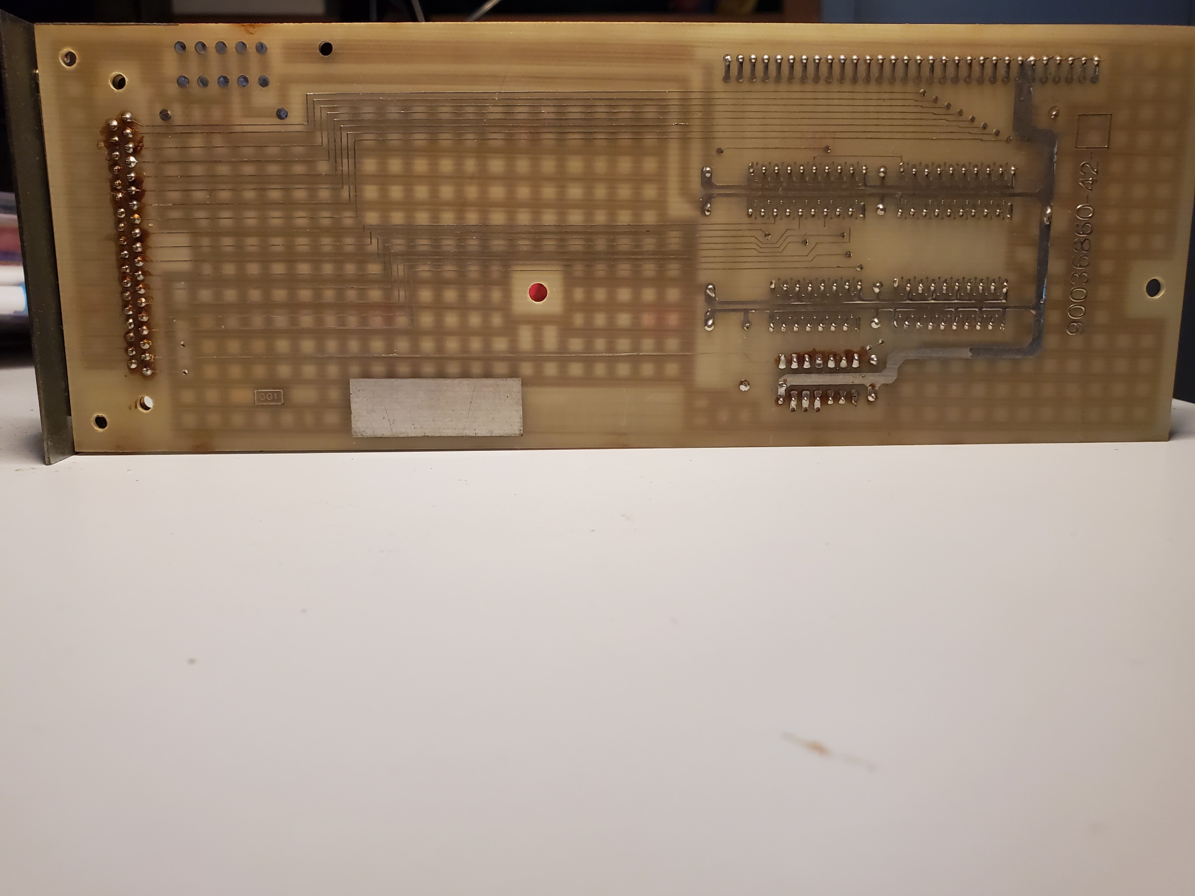

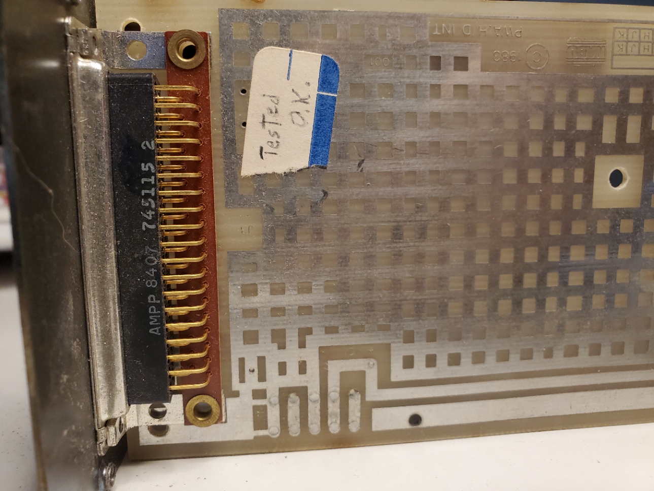

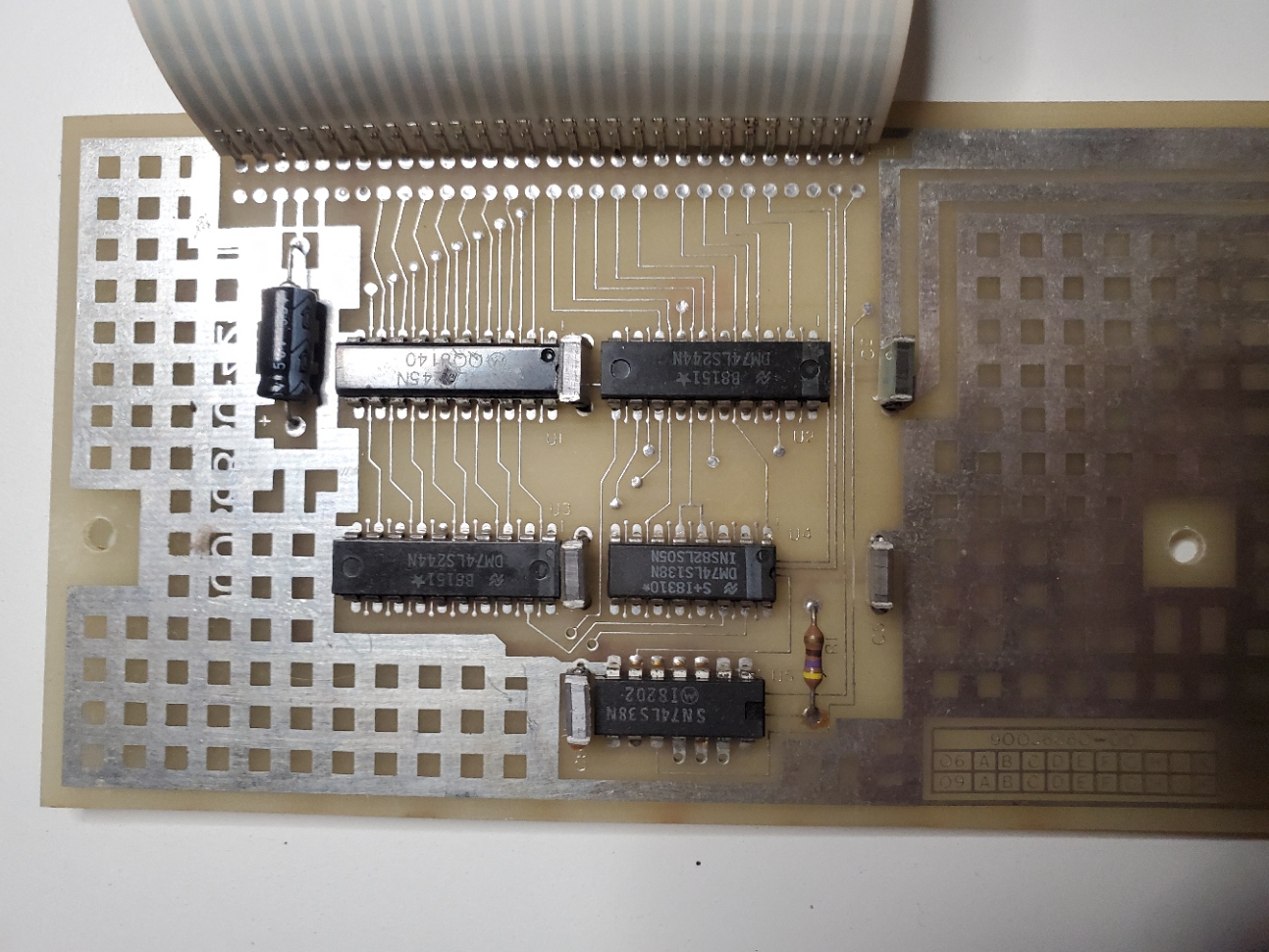

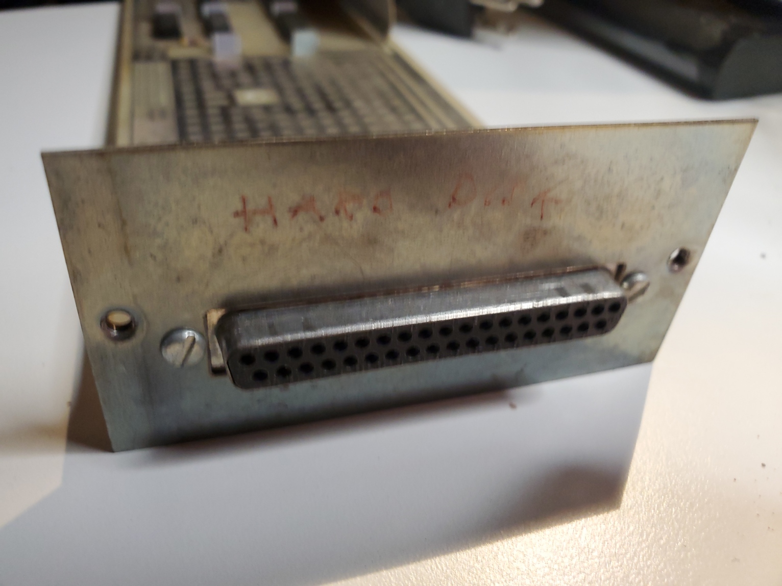

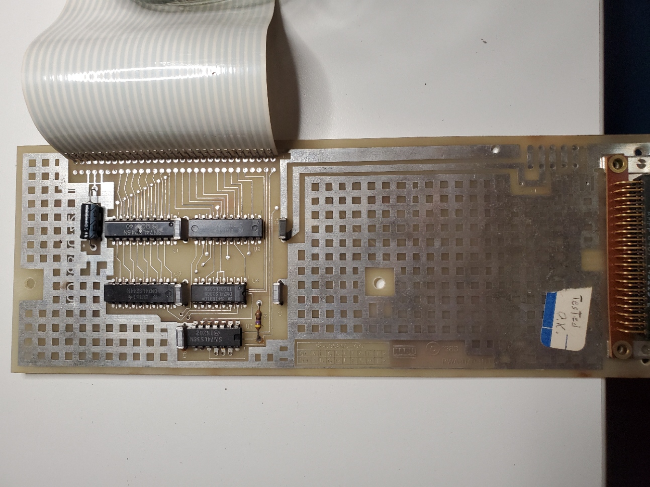

As requested by klyball, brijohn, and others, I'm putting up some photos of the Hard Drive Interface for reverse engineering purposes.
Do you need picks of the MSU controller as well? or just the cable? (which is, as far as I know is 1:1 on wiring)
If you need any others or closeups, just ask.
Re: Hard Drive Interface Photos

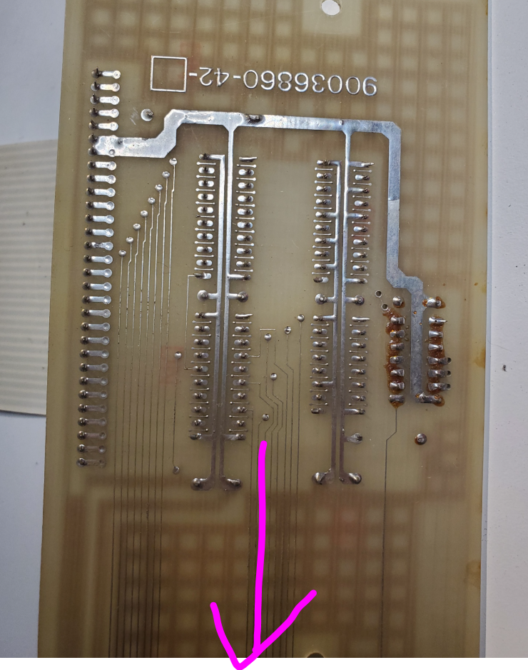

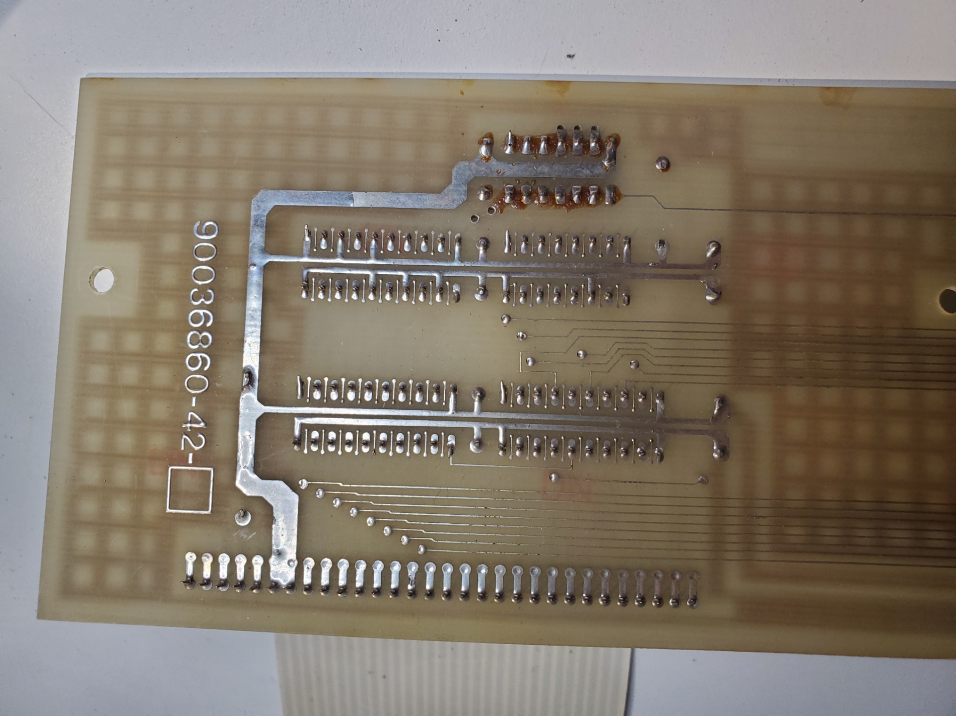

lol love how simple it is - since it's really only an adapter from the bus to wd1001. I think they're gonna need pics of the underside near the connector to see where the traces go on the plug.

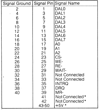

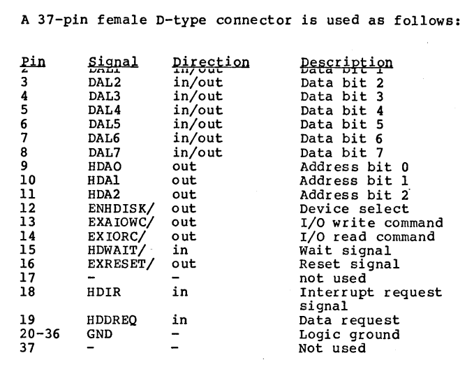

oh and here's the pinout on the back of the card - these simply connect on the other end directly to the wd1001 in the drive unit.
Here's the pinout for the wd1001 (not the connector of the drive unit). This is to show the connector of the hard drive adapter card has pins that connect directly to the wd1001.

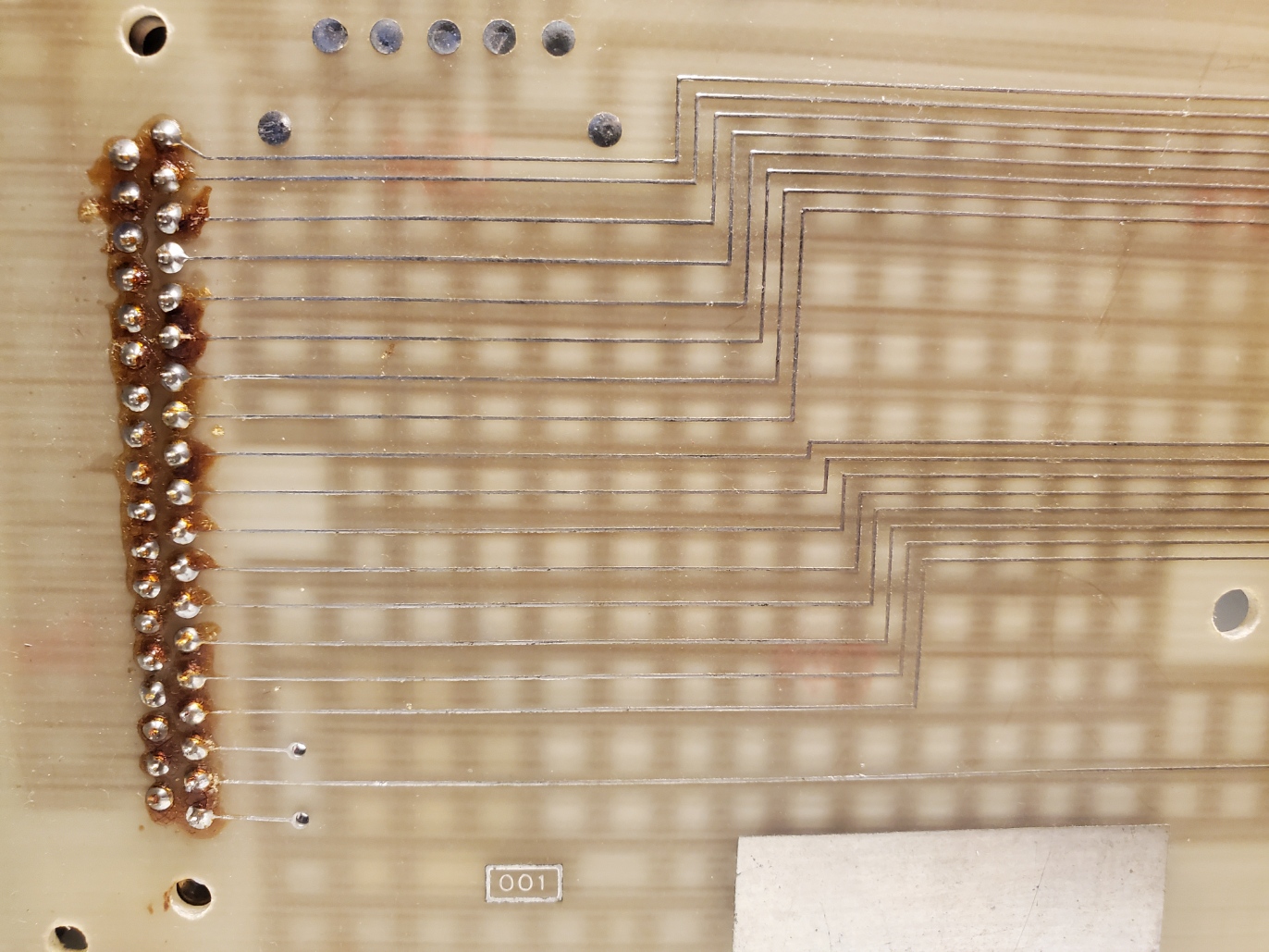

Ok, does this get the connector well enough?DJ Sures wrote: Sun May 07, 2023 8:32 pm lol love how simple it is - since it's really only an adapter from the bus to wd1001. I think they're gonna need pics of the underside near the connector to see where the traces go on the plug.

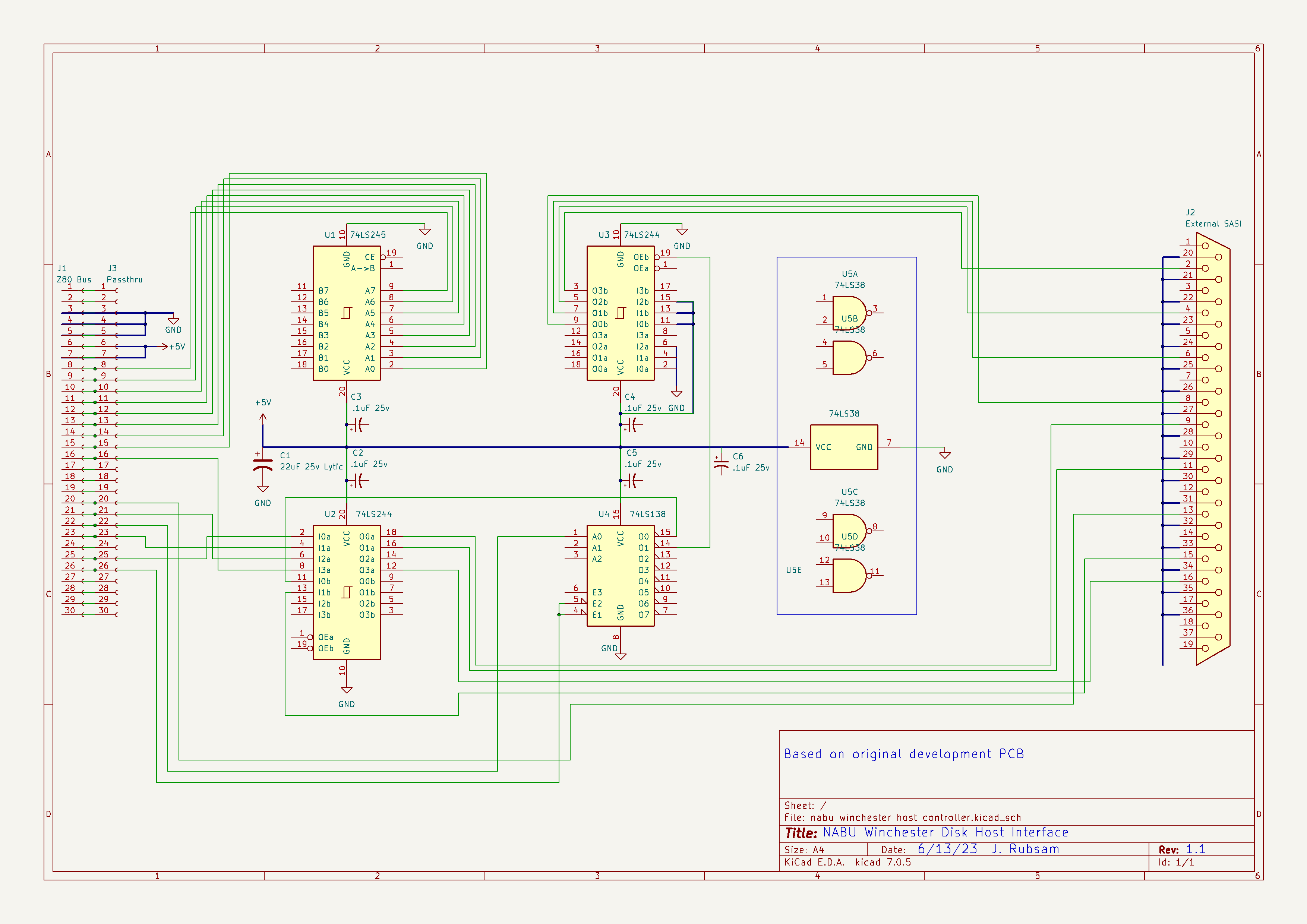

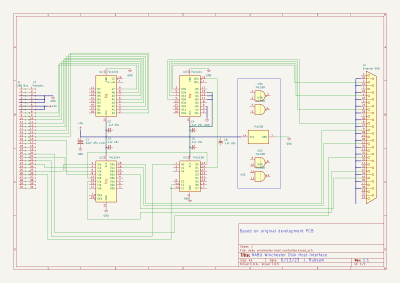

Thank you all for your replies. I decided to try and undertake replicating the SASI host adapter based on the photos that Leo posted.
Searching for a WD1001 turned up nothing, but recently a lot of purportedly new/open box Xebec s1410 SASI to MFM interface adapters recently became available. It appears that the board is simply Xebec's version of the interface the WD1001 provides, and also seems to be very well documented. I don't see why this board shouldn't serve as a suitable substitution. Like many of the early PC or XT HDD controllers, the board has a preprogrammed set of drive geometries for some of the more common MFM disk units available at the time. I have a handful of working examples of these drives so I should be able to make something work, and I don't see a reason why an MFM emulator shouldn't also work with it. Xebec documentation may be found here: http://matejhorvat.si/sl/slorac/delta/partner/s1410.pdf
I've attached an in progress version of the schematic for the Nabu portion of the host adapter, but I'm going to need some help to finish it as some of the traces vanish beneath ICs which are pretty much what's not drawn on the schematic from the P1/P3 interface connector, and the resistor shown next to U5 in the photos. Capacitance values shown are "acceptable" values in lieu of not knowing actual values.
