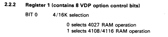

Question about the VDP register 1 bit 0 - the 4K/16K selection. It seems that all the ROM/BIOS out there set this bit to 0. Reading the documentation I think this should be set to 1 according to the TMS9118.PDF doc:
Am I missing something?

On a similar topic... Has anyone got the VDP interrupt to work? So far I cannot get it to fire on the Z80. I think I have done everything correctly:
1. Setup a new Vector table & update the I register
2. Set bit 3 (for VDP IRQ) in Port A of the sound chip (I/O address 41)
3. Cleared any pending IRQ in VDP by reading read status
4. Enable the IE (bit 2 in register 1) of the VDP
My next step is to probe the /INT line from 9918, then make sure it propagates through U33, U34 & U35. Since the HCCA interrupt seems to be working I'm guessing these are OK. My assumption is that the 9918 is not generating an interrupt... due to my bad programming & poor understanding of the system

Thanks productiondave for the feedback. I have registered the irq handler in the vector table. Actually added unique handlers for all 8 interrupts and I'm getting the HCCA Tx interrupt if I enable it in the control register.
I need to check my code again, I may be reading the VDP status at an inappropriate time, which clears the F flag.
By chance any insight on the 4/16K RAM selection? I've tried and both settings seem to work with a basic screen output. I haven't done any extensive RAM testing yet.

Thanks for all the help. Got it work tonight. The nabulib did help! My problem was the 9918 documentation labelled in the text description of the register 1 as bit 0 through 7, which i would interpret as bit 0 as the LSB. However the picture of the bits for register 1 shows bit 0 as the MSB!?!... Turns out the picture is correct and matches the source code from Nabulib. All is right with the world again.

This is one of the quirks with all TI documents. Loads of people have fallen for that trap
