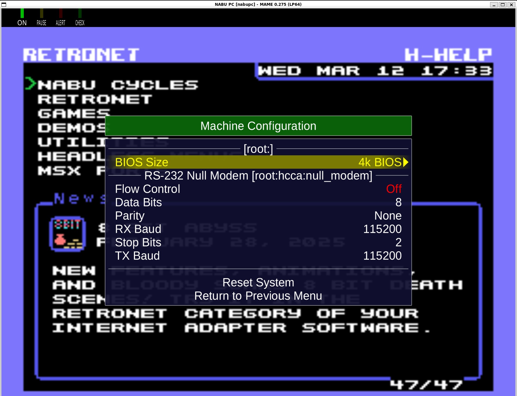

Sorry for the late reply. I could be wrong but I think it might just be a baud rate setting in MAME.
https://github.com/brijohn/mame/tree/nabupc_wip version is still the best to use since some features haven't made it upstream but I tried 0.275 on Ubuntu and got it to work after changing the default baud rate settings.
Push scroll lock in MAME to enable UI controls, push tab, go to machine configuration and set RX baud and TX baud to 115200. Set stop bits to 2.
DJ's adapter must also be set to 115200 for Linux.

You're right, it's the MAME serial port settings. I had 111900 baud and 1 stop bit. Changing it to 2 stop bits fixed it! MAME 0.275 on Fedora Linux.
Theoretically you could specify larger baud rates, since DJ's adapter just sees a TCP connection which doesn't have baud rates. But unfortunately, the emulated serial chip maxes out at 115200.
