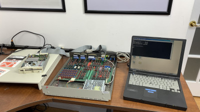

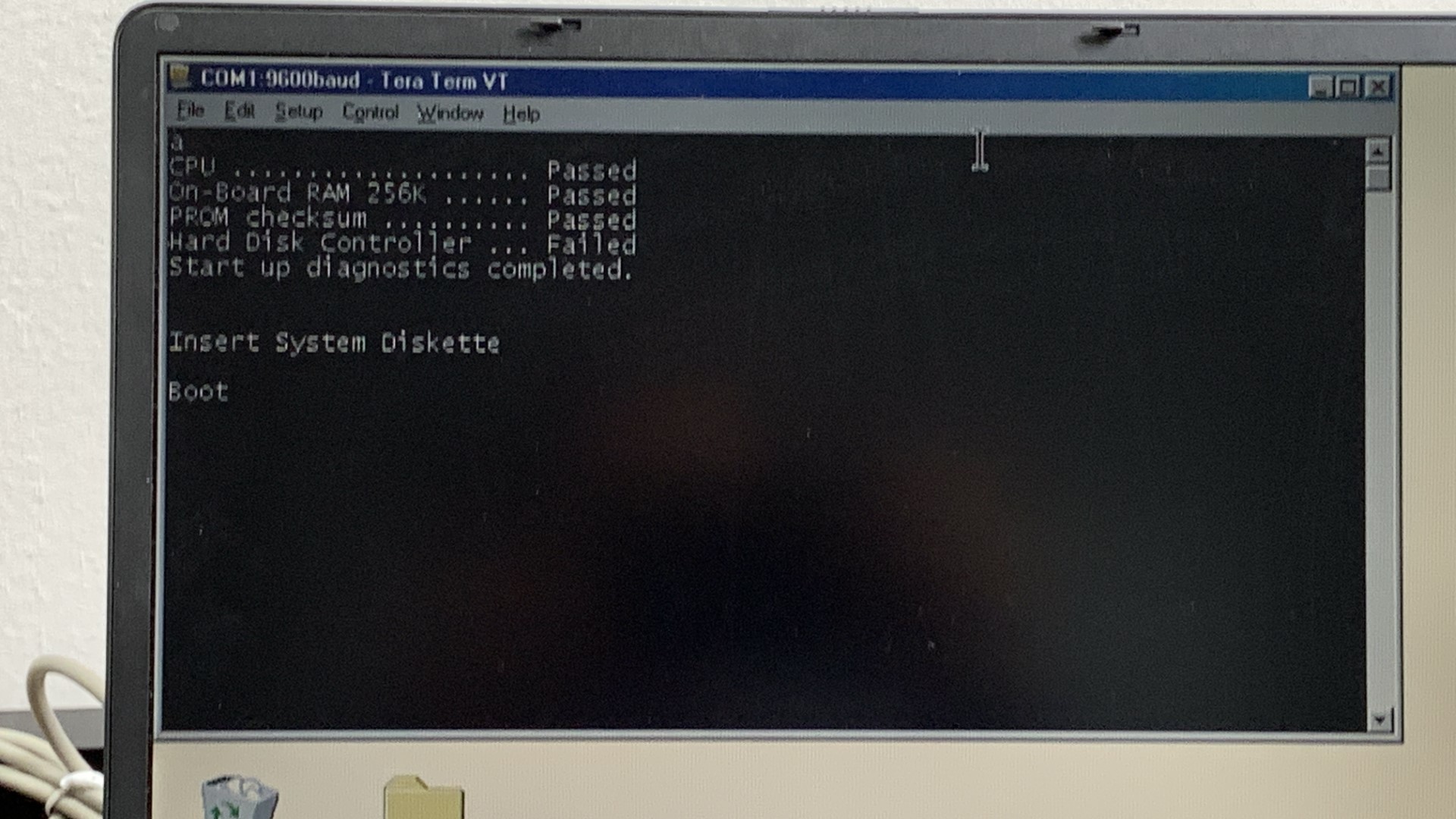

Well, I got a little further but not too far. After spending lots of time on it and the 1600 hanging when I started to communicate with it, I found a bad 74ALS645 at U42. I have just ordered a replacement. I made the proper DTE to DCE pigtail adapter and that didn't help, obviously, but that was before I found the issue.
I did make the floppy cable and at one point I got a floppy error. On a rare occasion if I got that far, it would load forever, stepping tracks once in a while but then it would die and not finish. I suspect the issue I am having won't let me get further.
I also have a real WD1001 so there's some possibilities of trying to re-create Leo's storage set up. That's a whole other kettle of fish and I'm not even thinking that far quite yet. Baby steps for now.
DJ, as for the other crap, do it for yourself and don't worry about the BS. It's much more satisfying that way :)

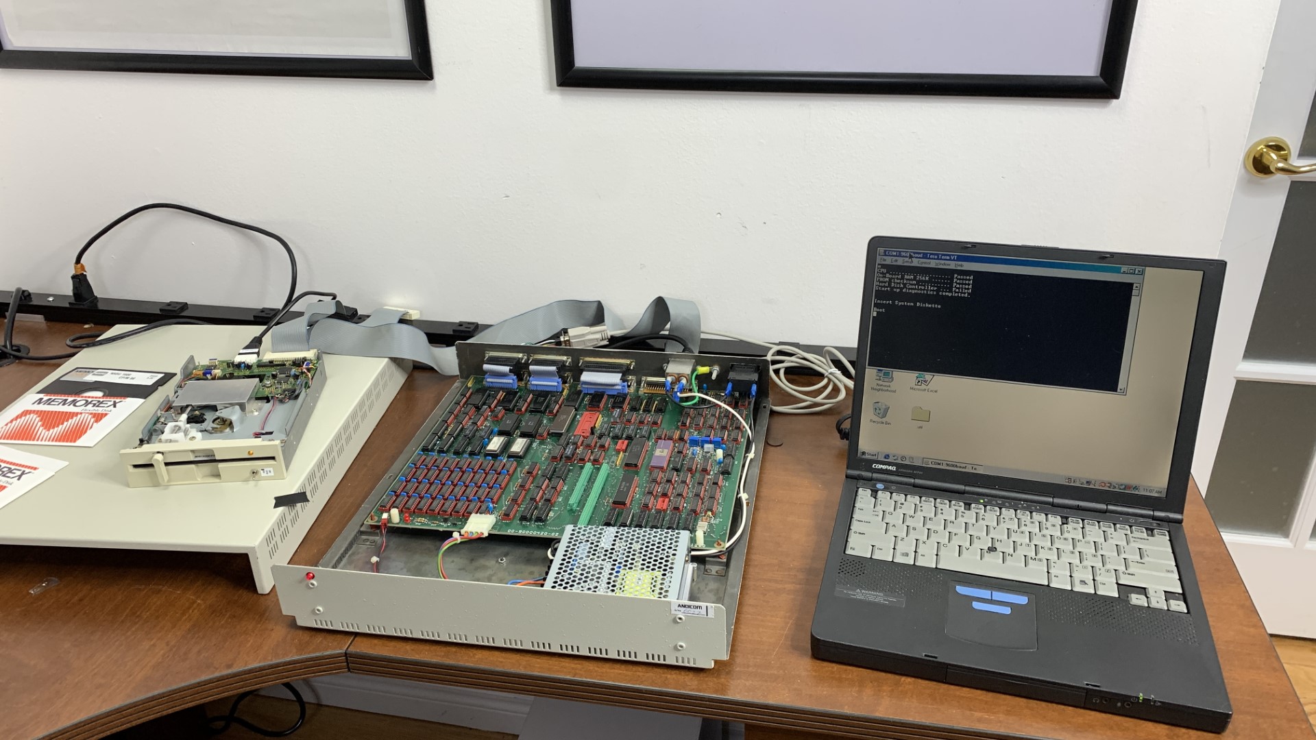

Nabu 1600 set up with floppy drive
Boot attempt but dies after disk access

I replaced the component but that did not fix my communication issues. What I was seeing was a initial boot okay but as I rebooted, it would get less and less through the initial POST until, for whatever reason, I had to turn everything off, wait a while and then try again.
As it turns out, I was missing all of the jumpers on J8 and J9. The schematics has these marked down. I put them in as noted for asynchronous communication.
I was also missing at T18 as noted in the schematics. Without it, the computer was in diagnostic mode. With it now in, it's in normal mode. Not sure what the difference is but it's probably best in normal mode.
I was using Dave Dunfield's QNX and CP/M 86 images. CP/M 86 gives me a disk error (I am running on a Gotek and the image was converted to HFE format as it was captured). QNX just goes to track 74 and slowly goes from one side to the other, then to the next track, then other side, and so on. It never boots.
Here's the kicker. My Nabu 1600 is earlier and it has the WD1793 floppy controller chip in it. The later ones (Dave Dunfield's for example) has a 2793 which adds circuitry for write precompensation. What this means is that I am not sure my 1600 can read those diskettes without modification to add the WD2793 chip like Dave's who provided the disk images. This modification is documented but it is a badly faded photocopied document and I'm probably not going to be able to follow it properly. DJ, maybe some good photos of your board (under the MMU board you have) would help.

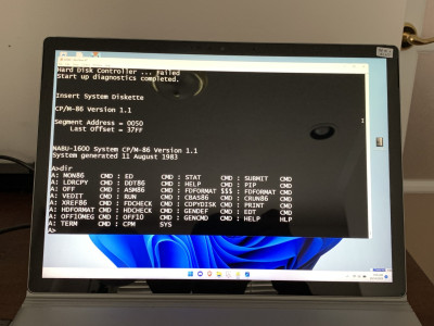

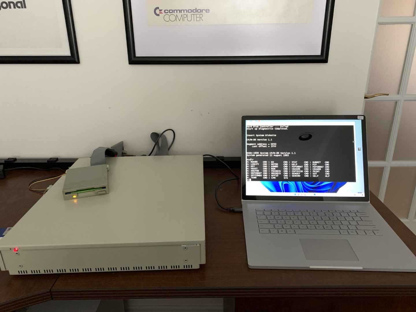

Post by snuci »

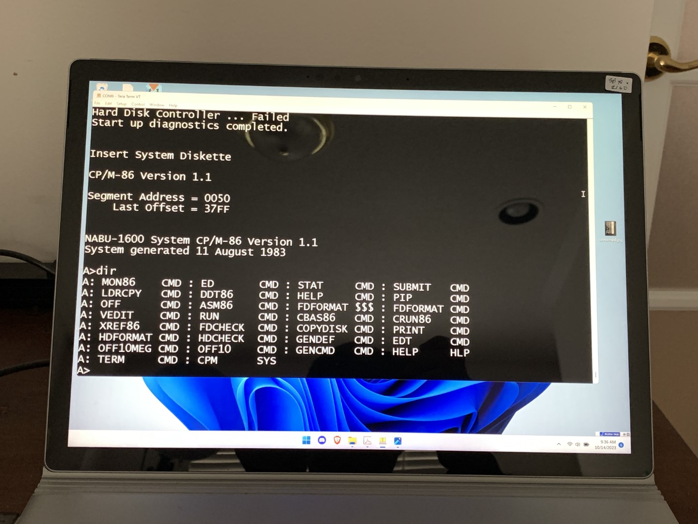

Forget about what I said in the last comment. I got the Nabu 1600 booting CP/M 86. I tried to get it to work on a Gotek and a 5.25" floppy drive but no luck there, yet. The floppy is a quad-density floppy disk that is not high density, but not double density so this presents a bit of a problem. I am certain I can get it to work on a Gotek but have not yet. For now, a 3.5" floppy drive works but it is a specially jumpered one. This particular drive is an Amiga compatible floppy drive that is set for DS0. The combination of settings on the drive makes it work.

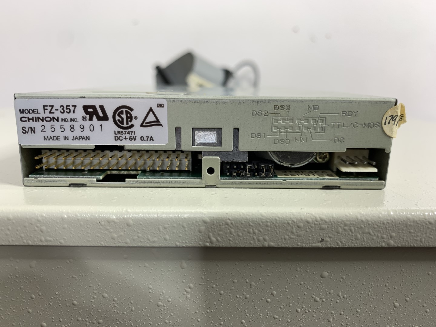

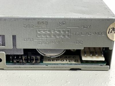

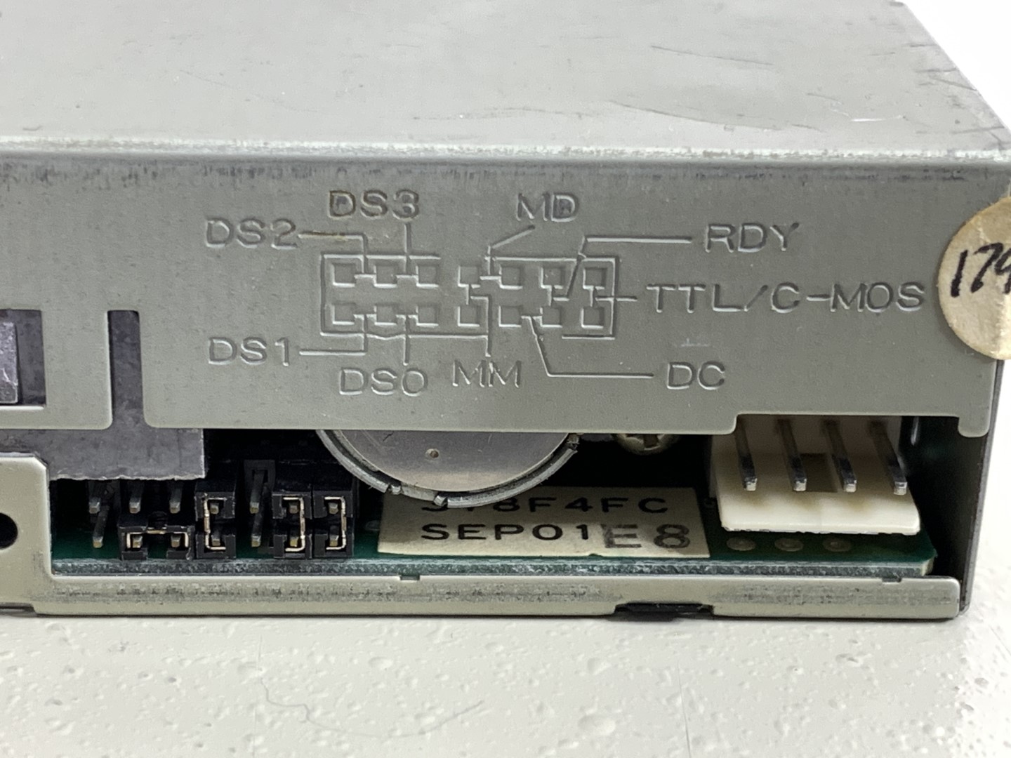

I spent yesterday trying to make the 1600 boot from a Gotek and I could not make it work. However, if you have the correct 3.5" floppy drive, you can boot CP/M from floppy like above. The one I am using is a Chinon FZ-357. Below is a picture of the back of the floppy drive. Make sure you get this specific model with this jumper configuration. There is more than one version of the Chinon FZ-357 and each version has different jumper layouts so you need this specific one.
Here is a close up of the drive jumpers. They need to be set up like this:

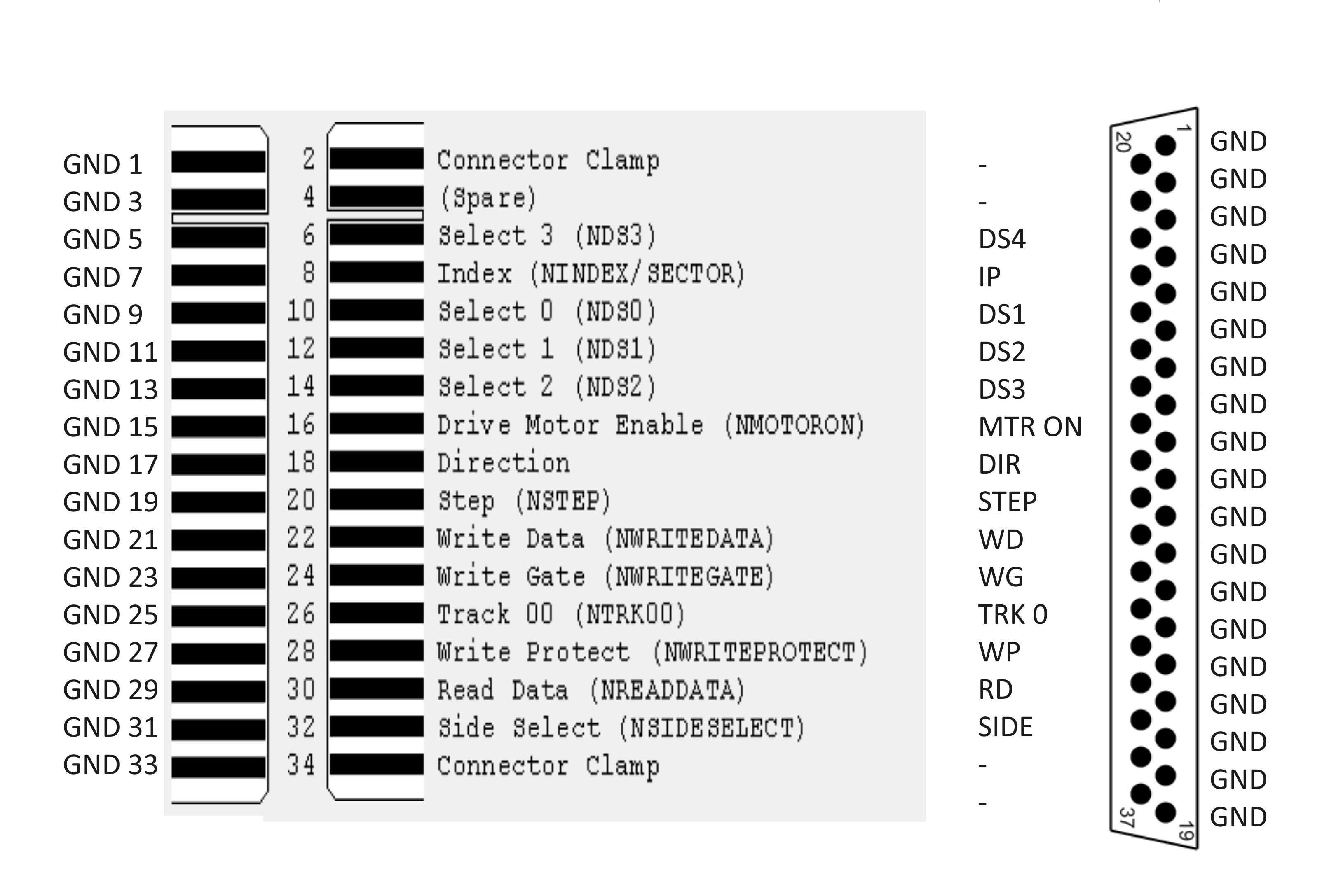

Now, you need to make a cable. Luckily, the cable is simple to make. You will need a DB37 ribbon cable connector. Here is the one I used from Digikey. You also need an existing floppy ribbon cable. Make sure it has a 3.5" floppy IDC connector that can be straight with the DB37. It must NOT be after the twist in the cable, if it has connectors after the twist. You basically line up pin 1 of a floppy cable to pin one of the DB37. It is marked in little numbers on the face of the DB37 connector. Here is a quick diagram that I used to make sure the pins lined up.
I use a vice to clamp on the DB37 onto the existing floppy ribbon cable and it works well to make sure the connector is on well.
Last thing you need to do is make a floppy. I used the CP/M ImageDisk image from Dave Dunfield's site here: http://dunfield.classiccmp.org/img42841/d/nabu1600.zip You will need to have a computer suitable to run ImageDisk with a 3.5" High Density floppy drive. Before you write the disk image, make sure Double Stepping is OFF. That is the only configuration setting you need to set other than which drive your 3.5" floppy is in.
Once you have the disk made, connect the cable, connect the drive (make sure you line up pin 1 and have a power supply for the floppy, insert the diskette and fire up the Nabu 1600. You should be all set.
