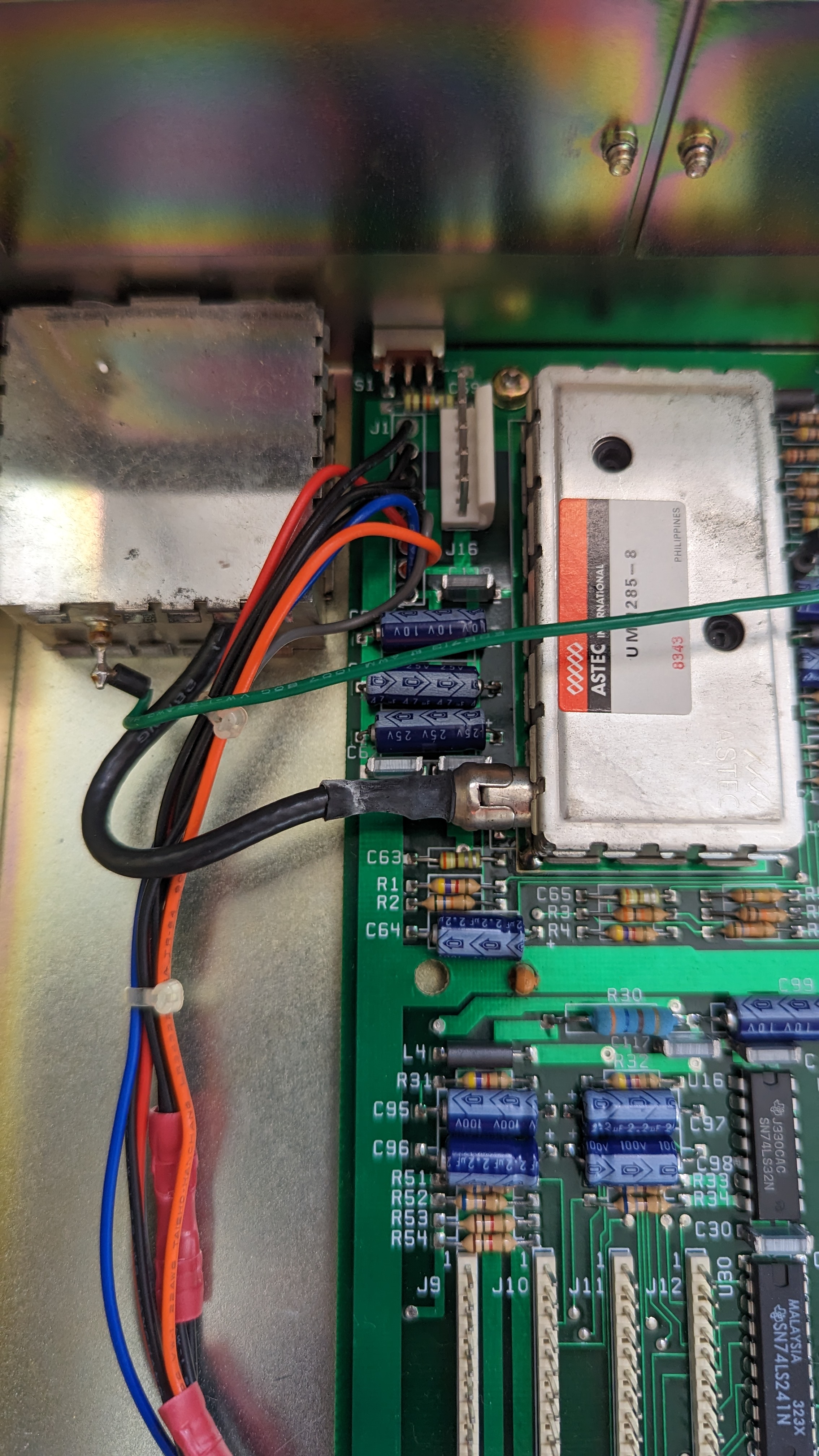

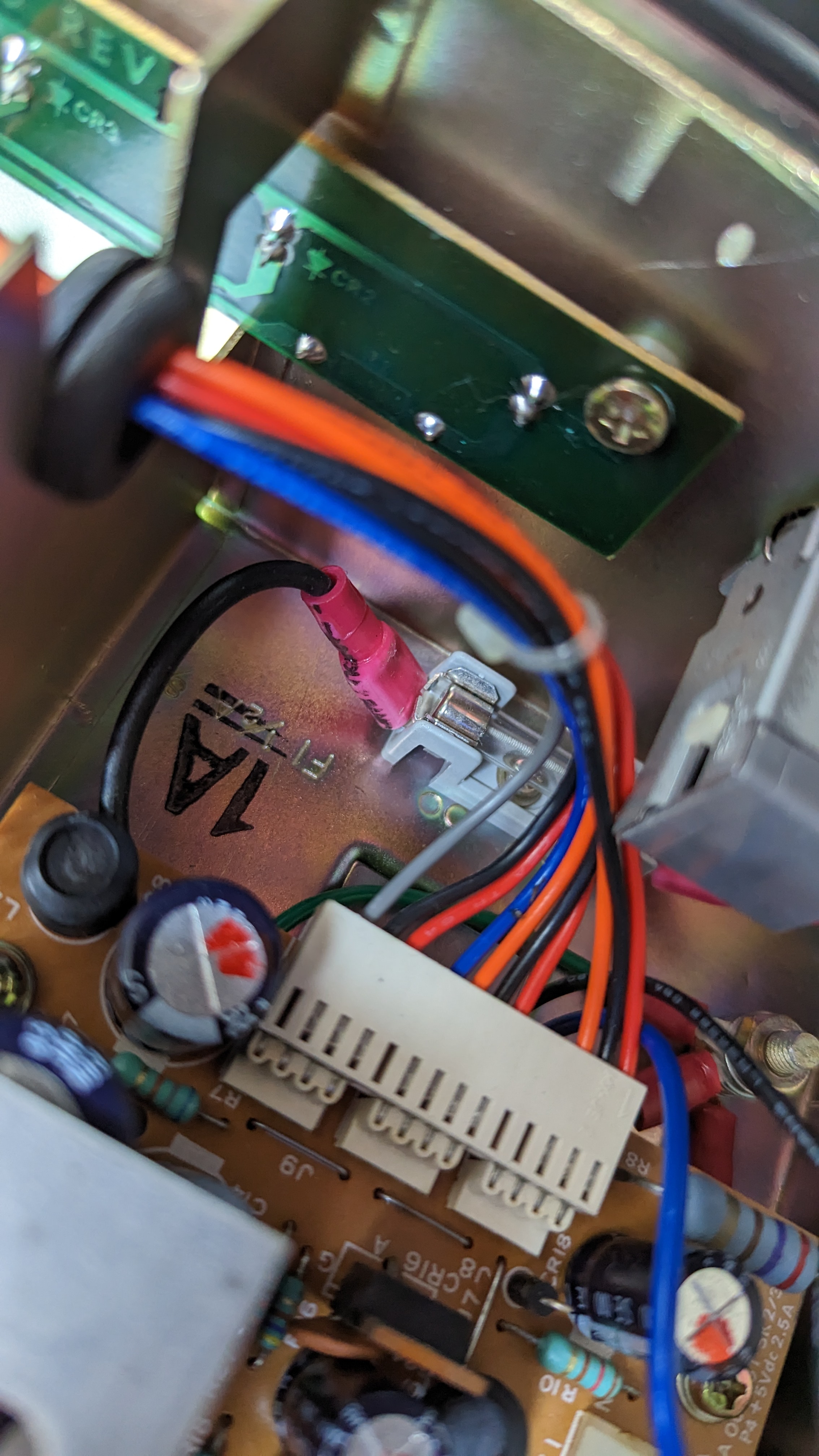

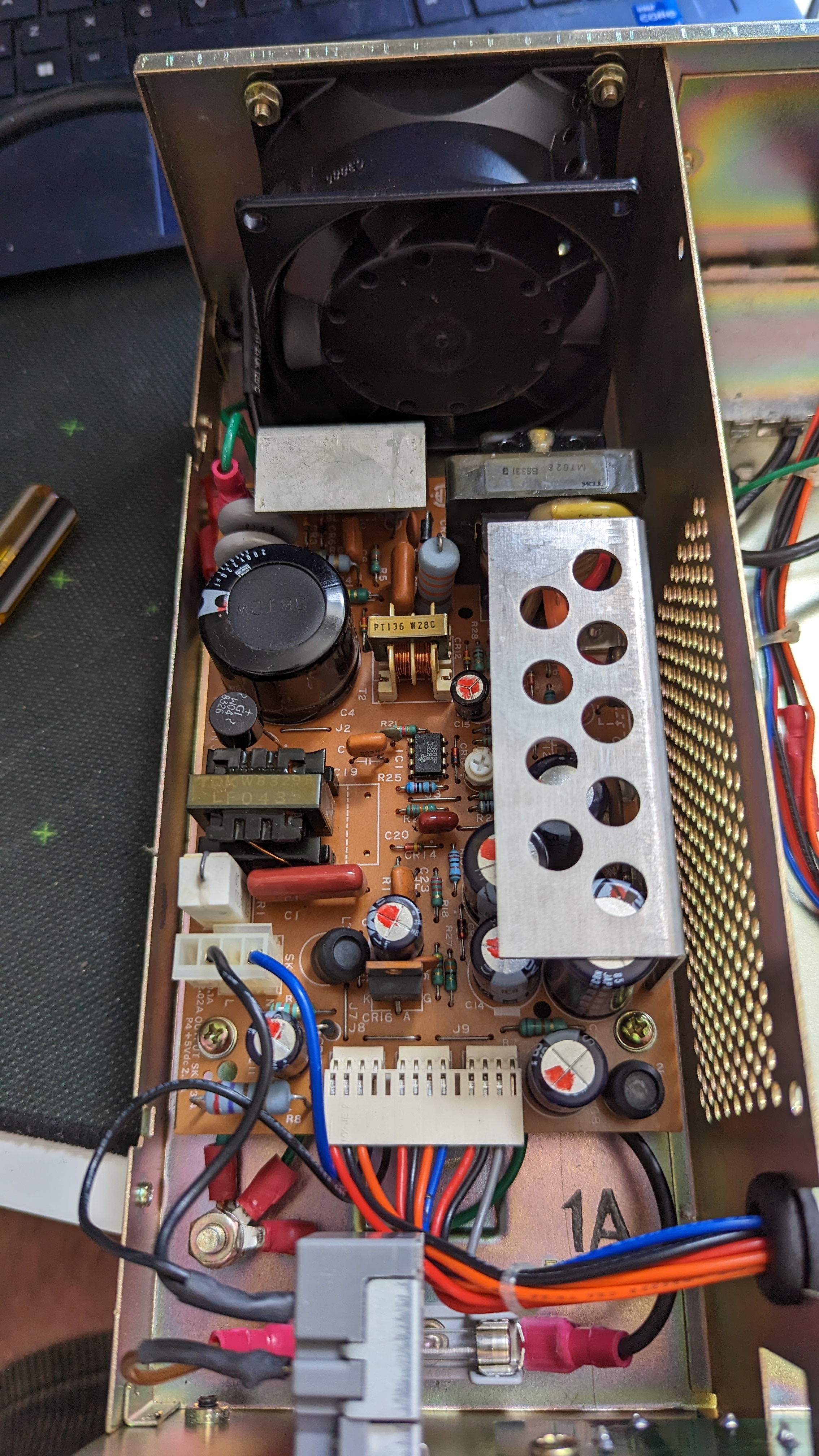

Re: Replacement PSU guide for 240v supply countries
These are the only photos I seem to have. I took these before I removed the PSU and fan. Feel free to use them if they are of any value to the doc.
You have also not finished section 1.1.3 in the doc.
