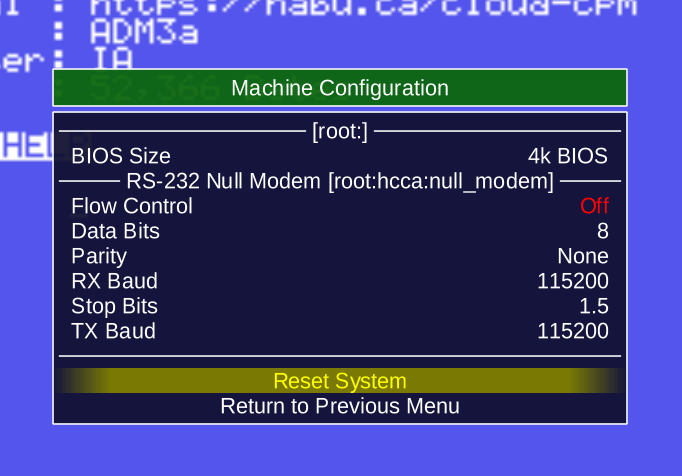

Here are the settings I'm using with MAME 2.78, see attached screen shot. 2.70 used a slightly lower baud rate and different stop bits.
Screenshot From 2025-08-03 10-16-39.png (60.92 KiB) Viewed 8622 times

I use this command line to start MAME:
mame nabupc -window -resolution 1024x768 -hcca null_modem -bitb socket.127.0.0.1:5816
I think that's what makes the null modem appear as the NABU network device. Also the Nabu Internet Adapter software is set to use port 5816 for NABUCOMMTCPServerPort, which is the default.
