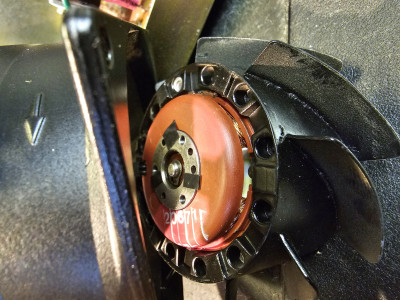

Just opened my Nabu... stuck fan.
I used the method to just loosen the three screws holing the fan/motor to the housing then re-aligning the fan. This worked for me, but I also found that I had to add a little black tape between motor and housing to give it a little more grip so it would not move. I found that once I re-centred the fan it would move just a little once I held it vertically to re-install. The three small screws holding the fan & motor to the housing are not great and kind of weak.
Here is a picture of small amount of tape, 3 pieces probably < 1mm square each, on the motor/fan before I put it back together. Now onto the bad video....
