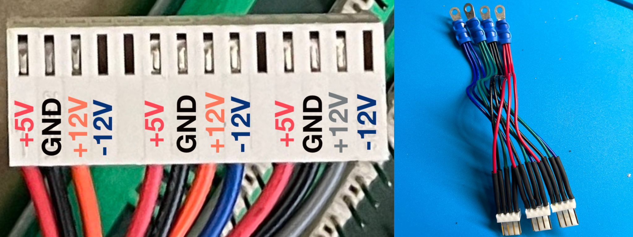

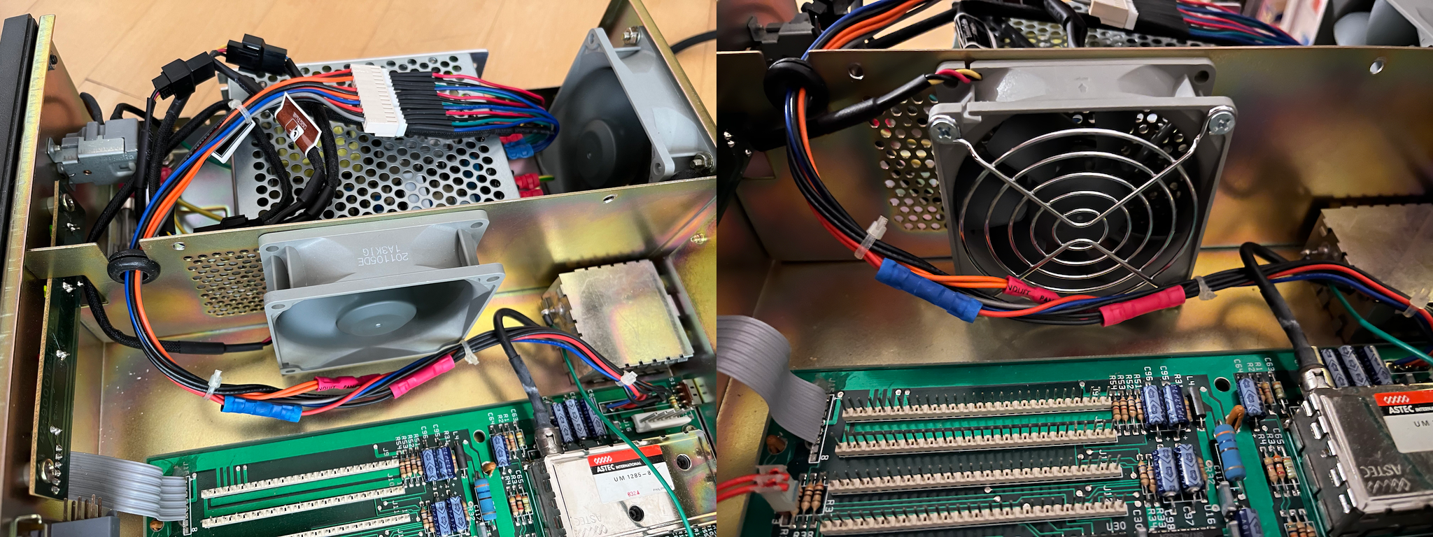

Hi friends, my name is Dave. A few pictures attached of my NABU.
As I'm in the EU, I swapped the PSU for a Mean Well RT-65B and made a custom adapter using 4 ring terminals and 4 MOLEX 22292041 connectors.
I also had to get a DC fan; since I was not overhelmed by the static pressure of Noctua's NF-R8 Redux (non-PWM) I got a second one. They are fairly cheap and quiet for what they are and simply run off of 12V continuously.

How is the second fan kept in place?

Thanks. :) Actually it's just held in place by the pretty strong permanent magnet of the motor.
I tried other things like zip ties which didn't work, so I'm probably sticking with this or 3D printing something very custom.
