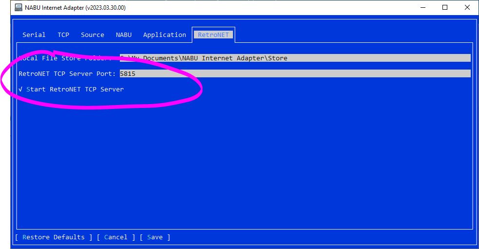

1) Enable TCP Server in RetroNET in the Internet Adapter settings window

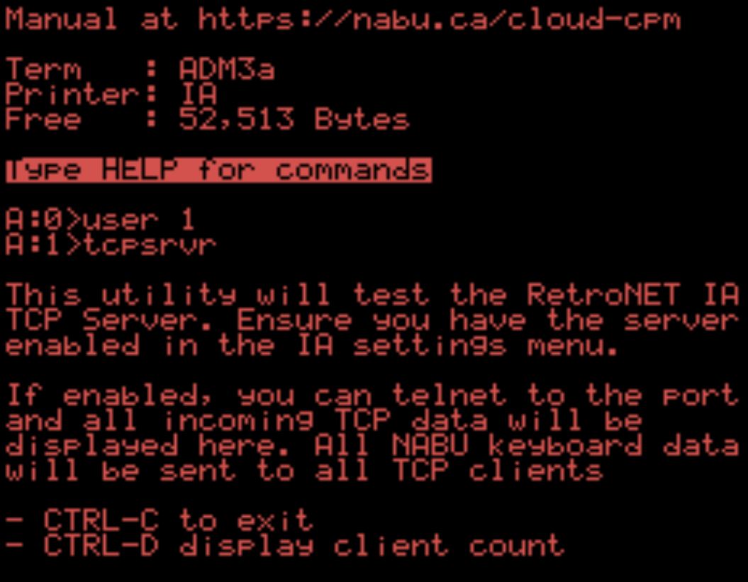

2) Go to A: User Area #1 and type TCPSRVR. The program will load

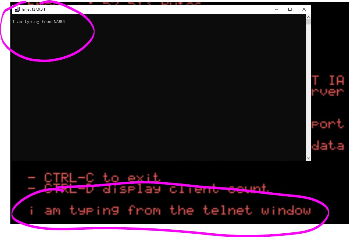

3) Telnet to your Internet Adapter's computer. You can do that locally by simply TELNET 127.0.0.1 5815
You can now type on either the NABU or the Telnet window and see the text back and forth
4) Press CTRL-C to exit the application

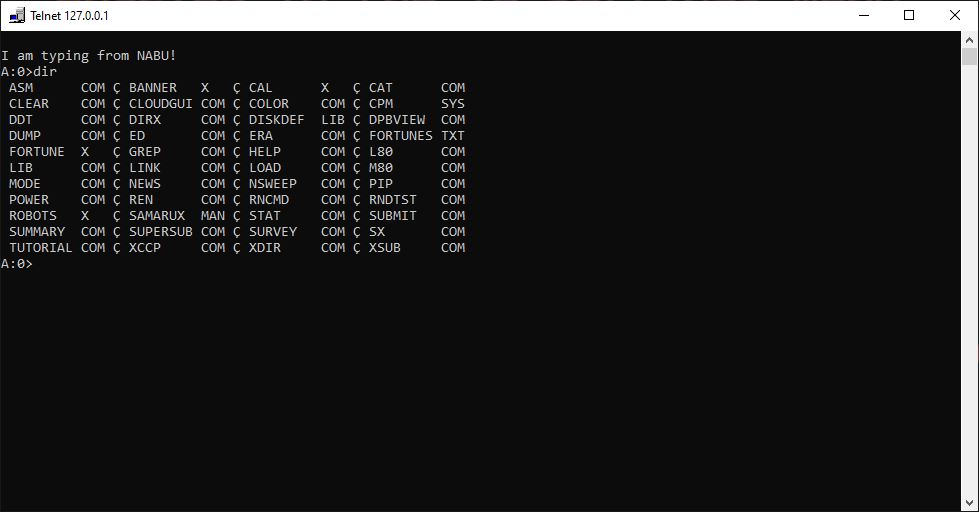

2) Type STAT CON:=UC1:
3) Now you can type on the NABU keyboard and see the output in the TELNET session
GET CONSOLE INPUT
Now let's get the input from the TELNET window. That is done from the READER device and assigning it to the UR1: device
1) type STAT RDR:=UR1:
2) Now you can use the telnet session entirely (I recommend using putty. If you use the windows telnet, you'll need to press CTRL-ENTER) otherwise the wrong enter code is set

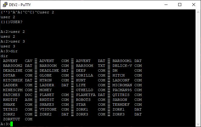

Hi all,
Just wanted to post a fun diversion -- I wanted to recreate my childhood WordStar and SuperCalc experience on an actual 80 column character terminal, so was trying the telnet redirect (DJ's work is so appreciated, thank you!), but the terminals I tried on linux (though they claimed it) didn't really seem to properly support ADM-3A, so the formatting was broken. I then got hold of a trial commercial ADM-3A emulator product to verify and it did work (unfortunately they are extremely proud of their software, big $$$, but I'm not spending money on this!). Now, I'm absolutely SURE there's a simple solution to this problem, but what I ended up doing was leveraging the very straightforward VT52 emulator project at https://github.com/kgober/VT52, adding a few lines of code to accept the ADM-3A control sequences for cursor movement and screen management, and boom it works a treat, looks great. Happy to post the mods to the project if anyone has interest. Note that it's a windows, not linux solution tho.
Cheers, A

Nice little project. You can always use cloud gui or rncmd to copy the words star project to your c: drive and any user area. Then you can reconfigure it for vt100 or vt52 or what ever is supported. The installer for wordstar allows confusing the terminal type

Yes I was wondering about that too -- that was going to be the next plan if I didn't have any success with the mod, and actually I'm going to try it out -- haven't yet played with the ability to make my own drives and so forth. Do you know if supercalc allows the same modification of the terminal settings?
I also ran across a cpm emulator on github that had a dbase II installation included, which was a complete blast from the distant past for me. Would love to recommend adding it to the cloud cpm suite if it's not already there!
