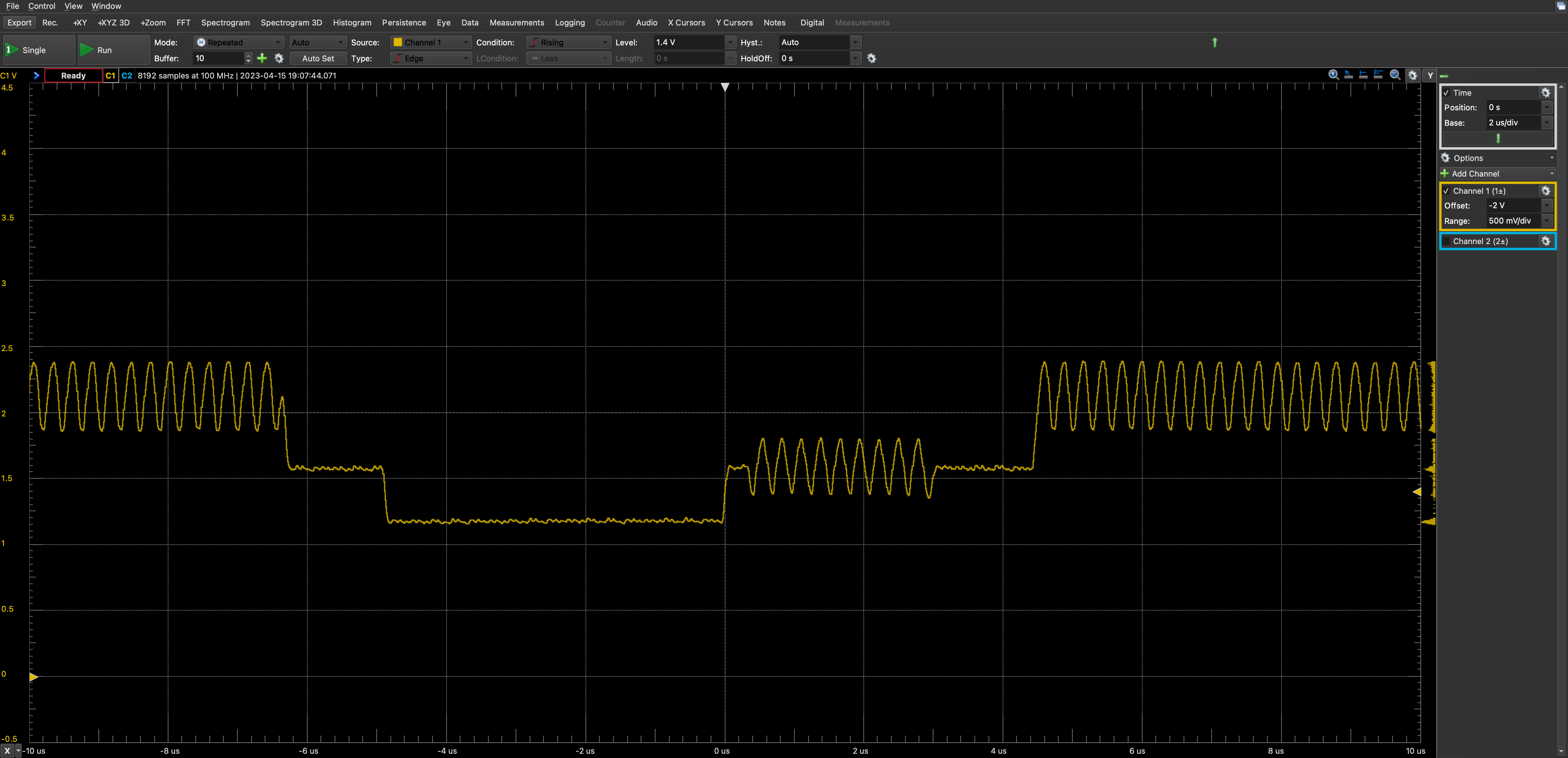

I put my scope on it and you can see the same issue that the John's Basement video shows, the DC offset is like 1.2V. This shouldn't be the biggest problem but it does seem to mess up certain capture devices as wells as composite to HDMI adapters.

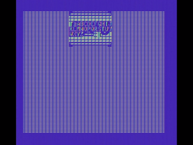

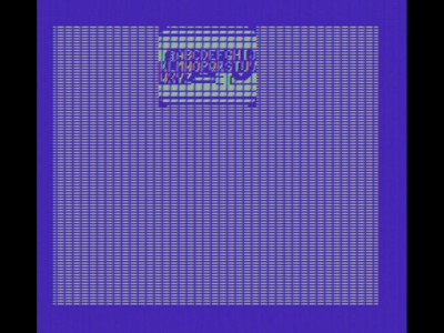

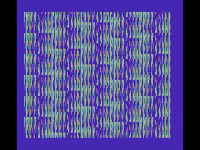

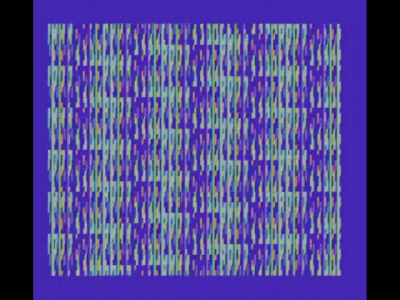

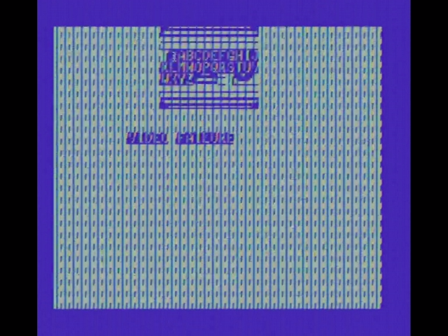

First power on for my Nabu and looks like I have a bad DRAM chip, U22 according to the Nabu PC Diagnostic manual by Rudy’s Retro Intel. Thanks Rudy for putting this together. I probed all the other Video DRAM chips and all look OK except U22, at lease they are output some data on Q, U22's Q is always low..
Tracking down some 4116 DRAM in Toronto, or ordering on line. Then will remove & replace U22 with socket & working chip.
Any recommendations best methods to remove board and replace this part?
