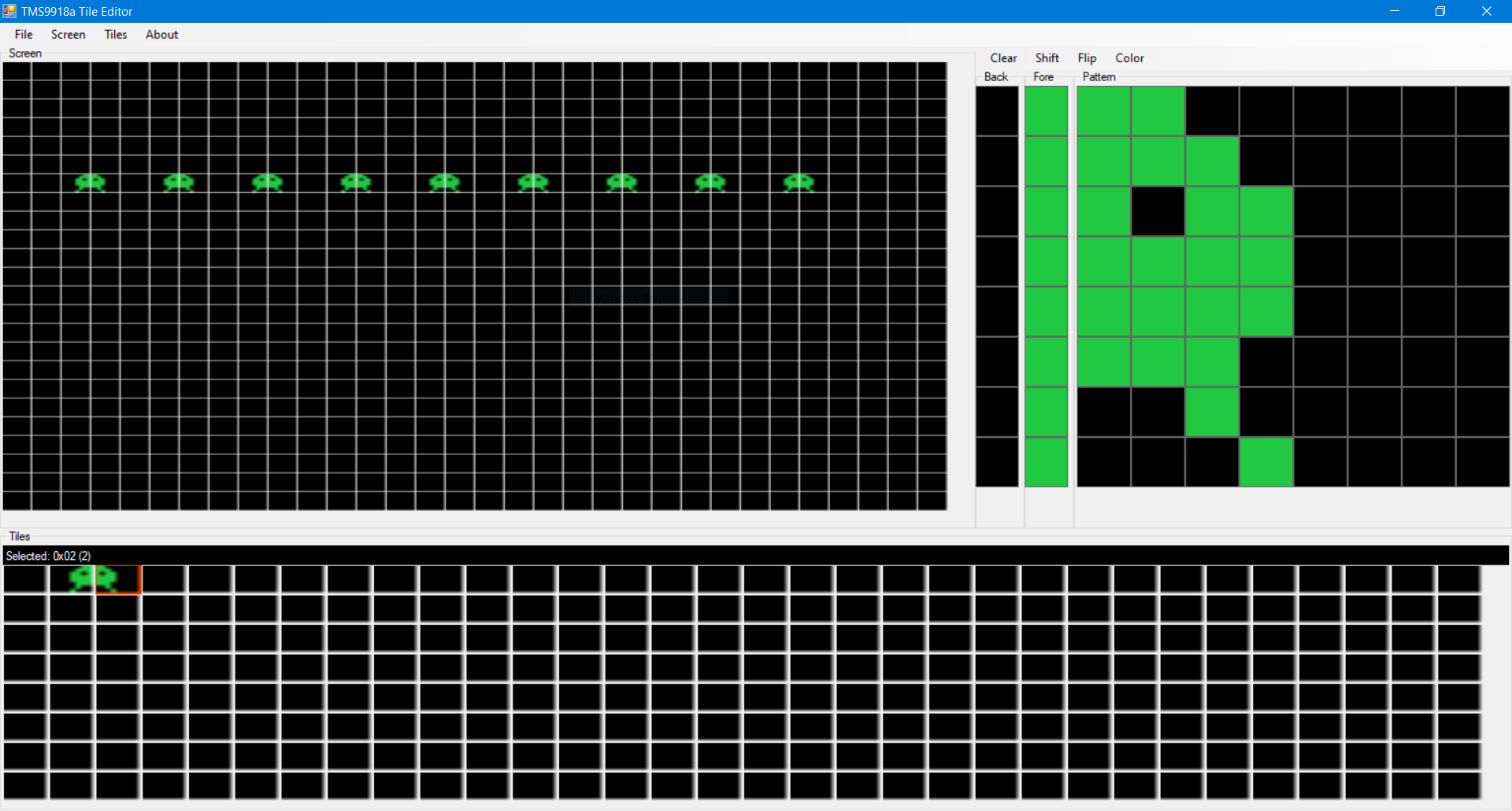

Oh i should add that i started on a tile editor. It's somewhat functional - but I'll release it soon as i finish a few more things. I'm making it to do what the existing tile editors don't do. You'll see :)
It'll do any tile, including fonts. And you can load existing fonts into it. It has import option
