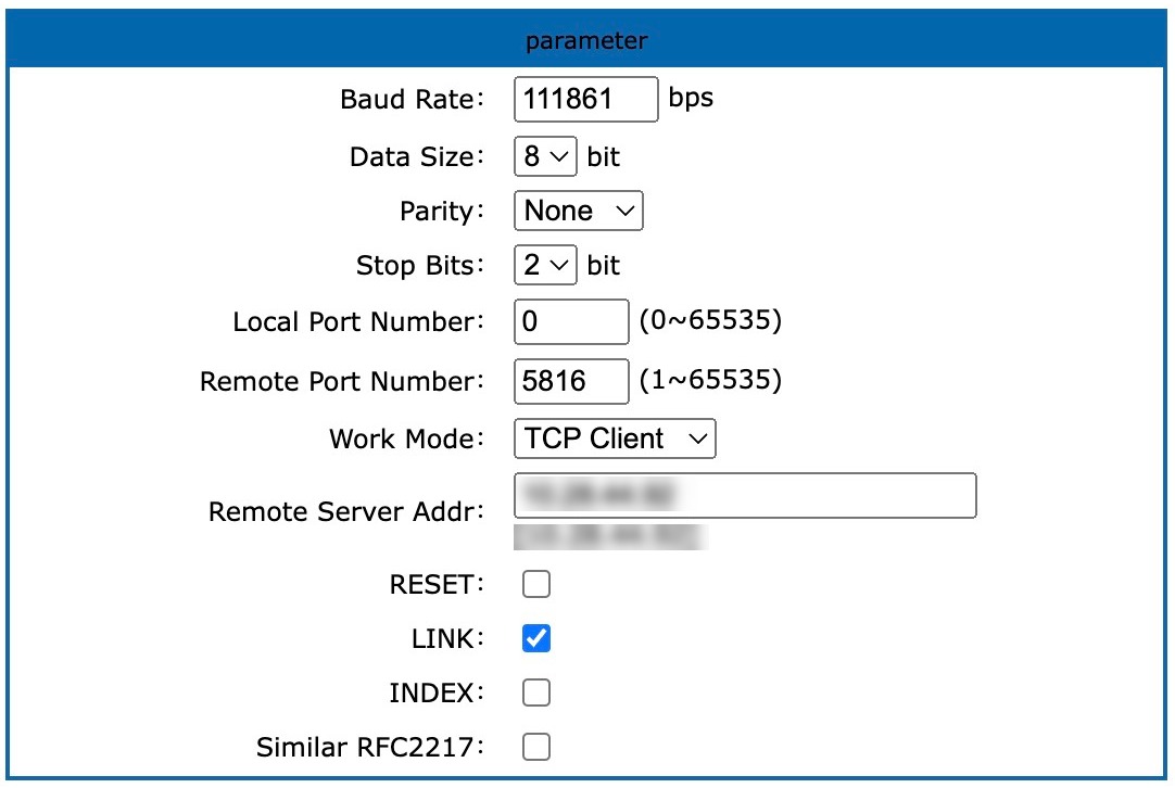

What settings are you using for the serial adapter side? Have mine set to the following:masto wrote: Sat Apr 22, 2023 11:58 pm I am using exactly that box with my NABU.
There is no reason to dink around with virtual com ports, just set it to TCP Client mode and have it connect to your internet adapter of choice. They all support this method, since it's what MAME uses.
Personally, I have nabud running on a linux server so it's always connected and ready to go. Of course it works with nabu.run as well ( but you need to run a websocket proxy.
But don't get two-way for some reason:
Cable appears correct, as best as I can tell. What are the LED's on the 422->Ethernet adapter doing when yours works correctly?

Thanks, finally got back to this and my previous cabling is off in some way, it looks like the pins on the NABU side aren't the way I documented them, they seem to be reversed. I switched them around and now I get connected.
I'm using the same settings you have, and it works, but it's noticeably slower than the straight RS-422 to USB cable, perhaps as much as 1/3rd the speed, or at least the perceived speed. Is yours that slow?
