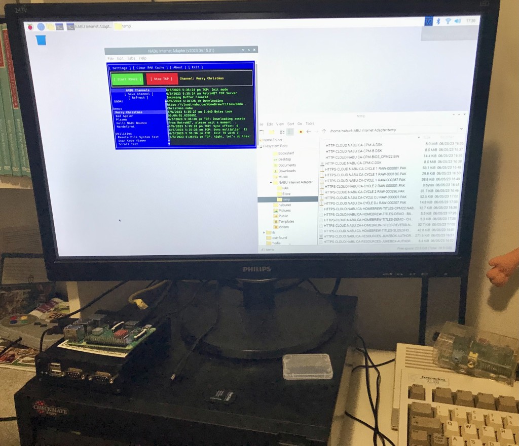

Fired up the old Pi (its a 1B), with the GUI I forgot how slow they areDJ Sures wrote: Thu May 04, 2023 10:23 am Yup. It’ll run on pretty much anything. Doesn’t really do a lot. Not cpu intensive at all

The Raspberry Pi pre 2 (eg, 1 or just B or whatever) won't run the Internet Adapters I've tried so far. Maybe nabud, I'm not sure. The other ones all require .NET core which doesn't exist for the processor in the old RPi's. I have a B+ serving up a BBS & some other low-resource stuff that I would *LOVE* to use with the NABU but, alas, it won't work. You'll have to use an RPi2 or newer.
(Yes, I tried compiling .NET. I forget where I found the info about the old ARM CPU not being supported by the code.)
Re: Pi Inside
That’s strange - you’d think the latest raspian would still work on those. Did you do an update? And still no joy? Arm should be arm. But also, remember to use the 32bit executable.

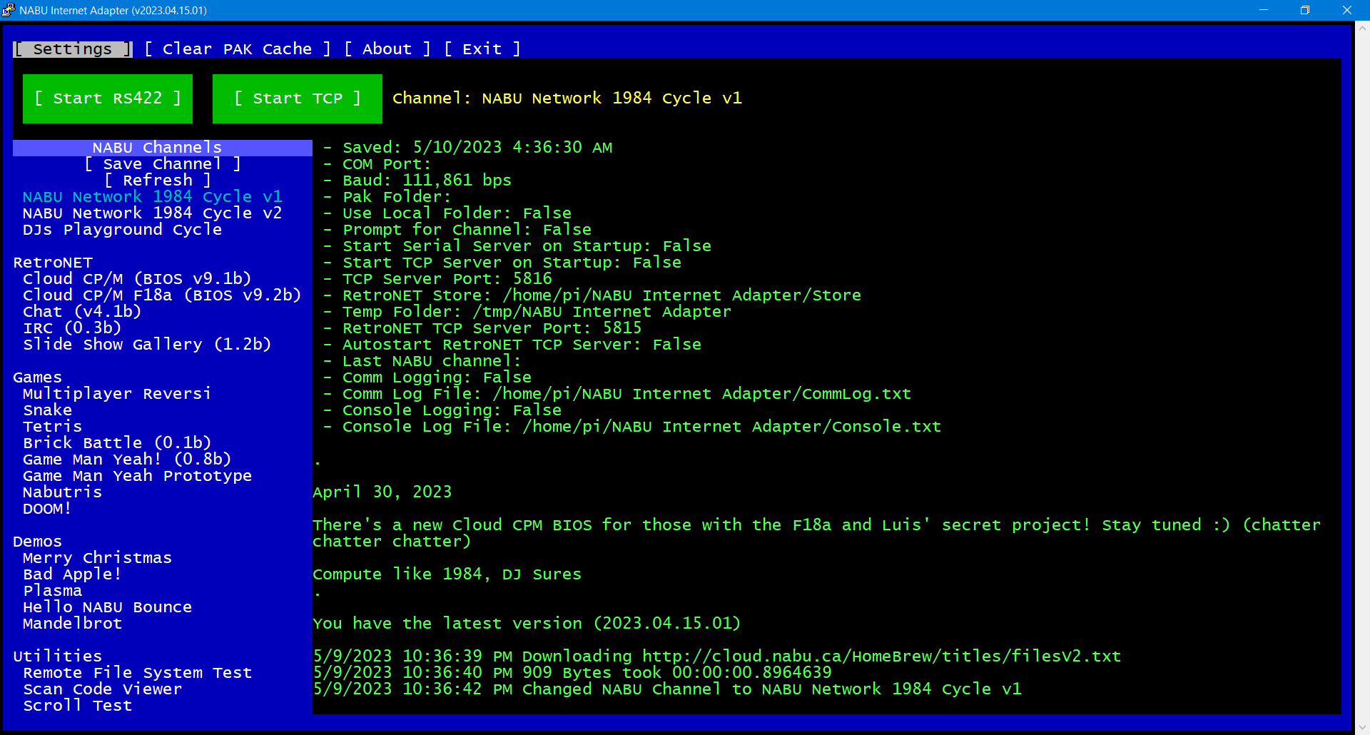

I tested on the oldest Pi i could find in my collection and it worked on the Pi 2 Model B Rev 1.1. I used the Linux 32 ARM internet adapter.
cat /proc/version shows...
cat /proc/cpuinfo shows...
Code: Select all
Linux version 5.4.83-v7+ (dom@buildbot) (gcc version 8.4.0 (Ubuntu/Linaro 8.4.0-3ubuntu1)) #1379 SMP Mon Dec 14 13:08:57 GMT 2020
p
Code: Select all
Hardware : BCM2835
Revision : a21041
Serial : 00000000cfe3e424
Model : Raspberry Pi 2 Model B Rev 1.1
